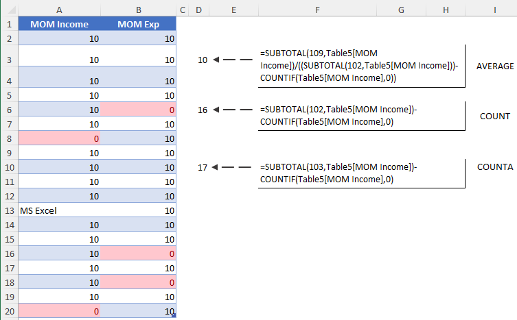

    . . . Actually my Table has cells having Zero Values. I have inadvertently mentioned it as Blank Cells instead of Cells having Zero Values. I have edited my question so please guide me how to solve the problem.
    Please check whether the following solution is helpful:
    • Formula for AVERAGE: =SUBTOTAL(109,Table5[MOM Income])/((SUBTOTAL(102,Table5[MOM Income]))-COUNTIF(Table5[MOM Income],0))
    • Formula for COUNT: =SUBTOTAL(102,Table5[MOM Income])-COUNTIF(Table5[MOM Income],0)
    • Formula for COUNTA: =SUBTOTAL(103,Table5[MOM Income])-COUNTIF(Table5[MOM Income],0)
    Please respond if You require further assistance. I will try My best to be of help.
    If I was able to help You, please mark My response as answer and helpful.
    Thank You!

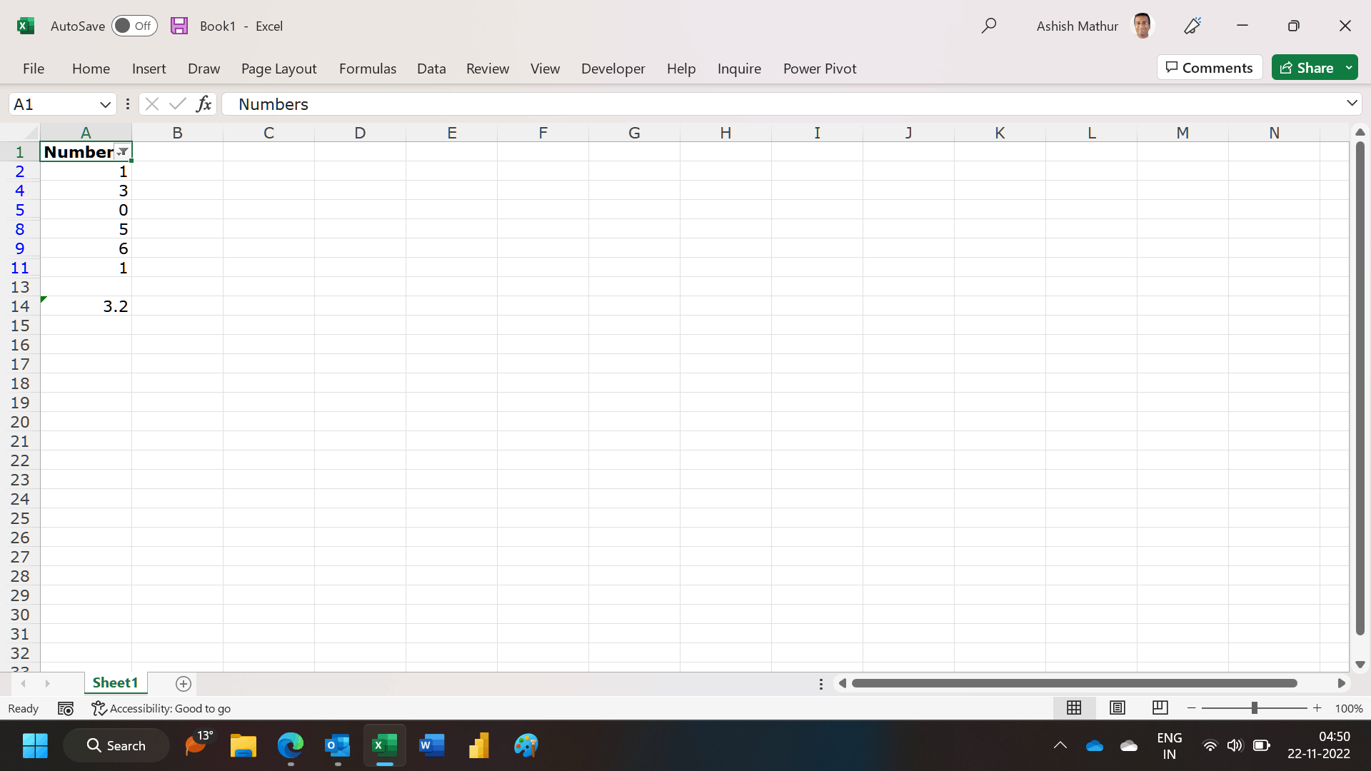

    In cell A14, enter this formula
    =SUMPRODUCT((SUBTOTAL(102,OFFSET(A1,ROW(A2:A11)-ROW($A$1),)))*(A2:A11<>0)*(A2:A11))/SUMPRODUCT((SUBTOTAL(102,OFFSET(A1,ROW(A2:A11)-ROW($A$1),)))*(A2:A11<>0))
    Hope this helps.

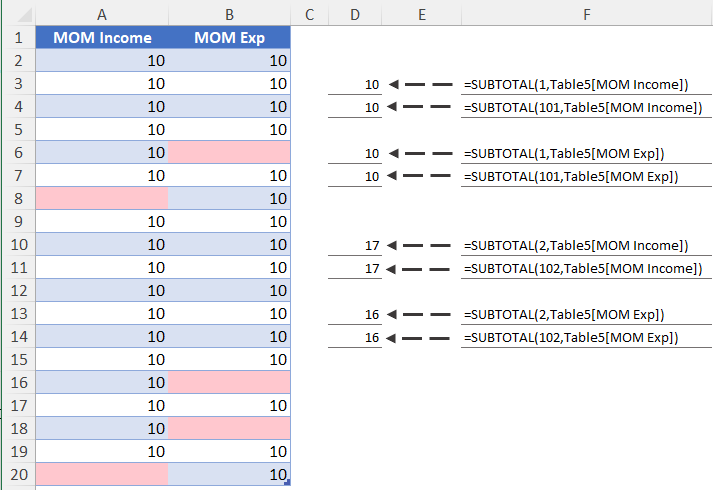

    Blank cells are excluded in calculations. Ensure that the cells which look like blanks are actually blank.
    2022-11-20T07:48:10+00:00
    I tried to recreate Your situation . . the formulas correctly calculated the result . . did NOT include the blank cells.
    Please refer to the following screenshot.
    To enable the Community to assist You, please share more information.
