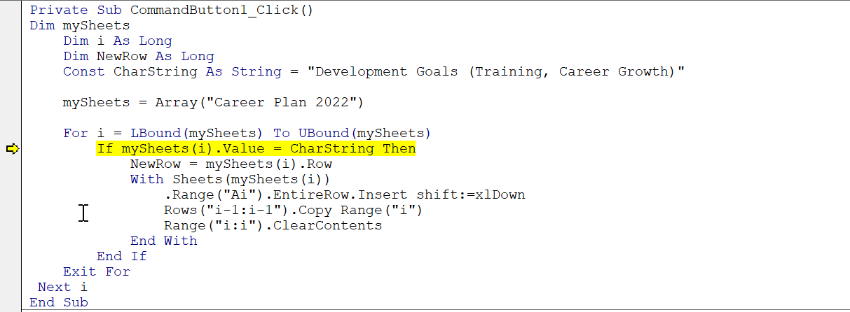

Hi, I have seen a few thread on this, however none have worked specifically for what I am trying to do.
I am create a template for a form that users will fill out in excel. The form is divided in sections and a few of these sections require an "Add New Row" button. I have the button set up and I am trying to program the code to add a new row at the end of the section. This new row should have the same formatting as the rows above. To do this I am referencing the cell below that has a specific text string in the cell, so that the new row is added above that cell. I have the following VBA code as of now. However, when I try to run the code by clicking the button, I get an error at the 8th line. I have posted a picture with the line highlighted. I am a beginner at all of this and am still learning VBA code. Is anyone able to help me with this please?
Thank you!
CODE:
Private Sub CommandButton1_Click()
Dim mySheets
Dim i As Long
Dim NewRow As Long
Const CharString As String = "Development Goals (Training, Career Growth)"
mySheets = Array("Career Plan 2022")
For i = LBound(mySheets) To UBound(mySheets)
    If mySheets(i).Value = CharString Then
        NewRow = mySheets(i).Row
        With Sheets(mySheets(i))
            .Range("Ai").EntireRow.Insert shift:=xlDown
            Rows("i-1:i-1").Copy Range("i")
            Range("i:i").ClearContents
        End With
    End If
Exit For
Next i
End Sub

  1. HansV 462.4K Reputation points MVP Volunteer Moderator
    2022-10-24T22:11:30+00:00
    How about
        Dim wsh As Worksheet
        Dim rng As Range
        Dim NewRow As Long
        Set wsh = Worksheets("Career Plan 2022")
        Set rng = wsh.Range("A:A").Find(What:=CharString, LookAt:=xlWhole)
        If Not rng Is Nothing Then
            rng.EntireRow.Insert
            rng.Offset(-2).EntireRow.Copy
            rng.Offset(-1).EntireRow.PasteSpecial Paste:=xlPasteFormats
            Application.CutCopyMode = False
        End If
    End Sub
    2022-10-24T19:24:05+00:00
    Change that line to
        If mySheets(i) = CharString Then
    2022-10-24T19:34:18+00:00
    Hi HansV MVP,
    Thank you so much for your reply. I made this change, and it no longer created an error in the code. However, now when I click the button, nothing happens at all.
  3. HansV 462.4K Reputation points MVP Volunteer Moderator
    2022-10-24T19:47:13+00:00
    Your array mySheets has one element: "Career Plan 2022"
    This is not equal to the value of CharString, so the part between If ... and End If is not executed.
    What did you expect?
    2022-10-24T19:59:11+00:00
    I thought that setting mySheets = Array("Career Plan 2022") would set the overall range, the for statement searches that range for the cell of value i within that range that matches the character string. I am new to this, so I am still trying to make sense of how VBA functions work. What would you recommend I do to have this same process be carried out?
