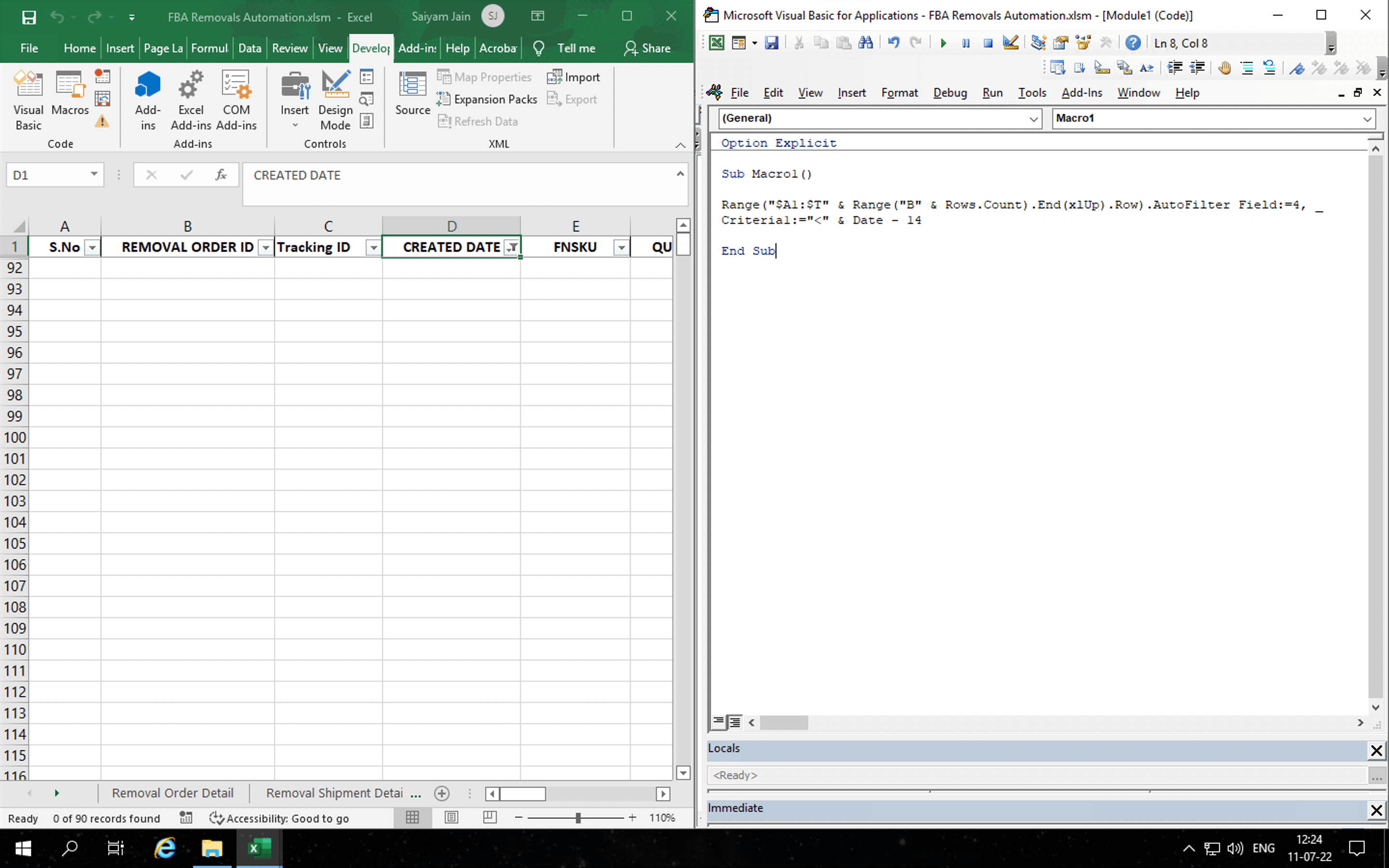

I have a dataset in which I have a date column which i want to filter and the basis of that filter is "is before or equal to for today i.e. in vba date -14" and this filter is not working properly. I also try to store this value in a variable and then i tried to use it filter but nothing works.
I am pasting a screenshot for my code
And when i run this code the result is blank

    For dates you need to convert the argument into a number.
    Andreas.
    Sub Test()
    Range("A1").CurrentRegion.AutoFilter 4, "<" & CLng(Date - 14)
    End Sub

    Thanks for the help it resolved now
