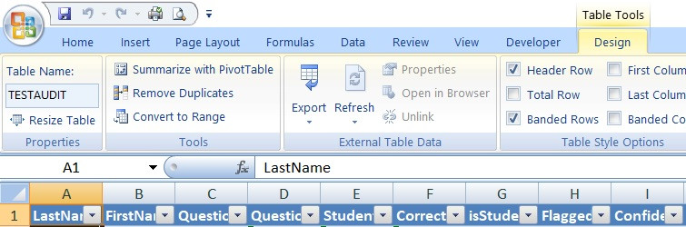

I have the following table. What is the code to pull that table name (TESTAUDIT) to use in a macro?
I have the following code to uncheck a couple of items but need to replace the "TABLE1" with the actual table name:

    With active cell in the table, try
    ActiveCell.ListObject.Name
    if you want to call from anywhere else
    Try this function. It will give you the table name
    Function CellInTable(thisCell As Range) As String
    Dim tableName As String
    tableName = ""
    On Error Resume Next
    tableName = thisCell.ListObject.Name
    CellInTable = tableName
    End Function
    to call the function, pass it the address of any cell in the table or click on any cell in the table and pass ACTIVECELL
    Sub Test()
    Debug.Print CellInTable(ThisWorkbook.Worksheets("Sheet4").Range("A1"))
    End Sub
    Sub Test2()
    Debug.Print CellInTable(ActiveCell)
    End Sub

    ActiveSheet.ListObjects(1).ShowHeaders = False
    ActiveSheet.ListObjects(1).ShowTableStyleRowStripes = False
