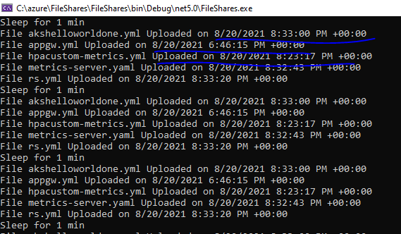

    I was just trying to simulate your requirements using C#.net , below are the sample code snippet . Let us know if that helps.
    Reference document from which below code snippet is customized , it is a console based dotnet application:
    https://learn.microsoft.com/en-us/azure/storage/files/storage-dotnet-how-to-use-files?tabs=dotnet
    125201-dotnetcode.txt
    Try to run the above code snippet in a loop sleeping for a particular time period
    Try to extend the code , get the timestamp and write the additional logic based upon your requirements after retrieving the timestamp
    When you run that code the output looks something like below:
    Let us know if you need additional help.
