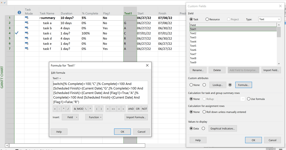

I am trying to put in a RAG status field which references the following fields (% complete, Finish Date, Plan in Place)
I'll be using the following conditions
If the % complete is 100% then the result is C (for complete
If the % complete is less than 100% but the finish date is still in the future then the result is G for Green
If the % complete is less than 100% and the Finish date is before todays date but there is a plan in place (the plan in place field is a Y or N dropdown) then the result is A (for Amber)
If the % complete is less than 100% and the Finish date is before todays date and there is no plan in place (the plan in place field is a Y or N dropdown) then the result is R (for Red)
Any help with the formula needed would be greatly appreciated

John Project 49,715 Reputation points Volunteer Moderator
2022-07-01T15:38:21+00:00
Ginsterman,
Just for reference, since you are only looking for a "yes" or "no" for the "plan in place" custom field, a Flag field seems more appropriate (i.e. no need to create a value list). So, while waiting for you to respond to my latest post, I assumed the Flag1 field is used for the "plan in place" and I used the Text1 field for the graphicical indicator field. Here is the formula, using the fields I chose, to do what you want. However, if you really have your heart set on using the Text1 field for your "plan in place" field, then you'll need to tweak the formula to look for "yes" or "no" instead of true and false and of course put the formula in whichever other field you are using for your graphical indicator.
Give it a test, let me know if I missing anything.
John

    2022-07-01T13:38:49+00:00
    Hi John, its a custom field called "Plan in Place", this has a dropdown where only Y or N can be selected
  2. John Project 49,715 Reputation points Volunteer Moderator
    2022-07-01T13:26:14+00:00
    Ginsterman,
    Which field are you using for "plan in place"? It will be easier to write the formula for you.
    John
