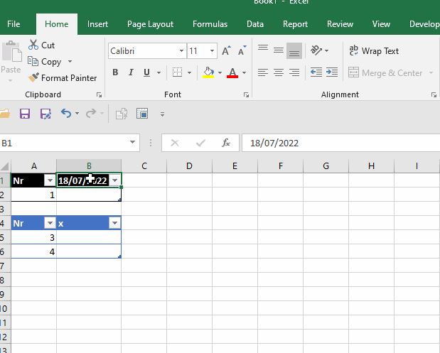

  1. Andreas Killer 144.1K Reputation points Volunteer Moderator
    2022-07-18T07:28:32+00:00
    NO SYSTEM RESTORE OR OTHER REPAIRS NEED TO BE PERFORMED!
    The behavior is normal and by design:
    A table converts anything that you type into the headings into a unique text!
    Tables have been designed for data processing, therefore the headings should never change and must be unique.
    This is the only way they can work as link between Excel and Power Query / Power Pivot.
    Andreas.

    Hi Jung, I just tried method 1 2 and 3, and none of them are working. I was able to create an excel and get the same problem.
    I will attach a picture of error excel. There you will find 2 tables. What I was trying to do was reference one table header with another cell. In this example, I created 2 tables, one below the other. In this case I made the headers of the first table to be dates. And I wanted to make the second table have headers referencing the first tables' header.
    If you see, G11 should have ''=G5'' in its formula bar. Instead, it has something else.
    If you have additional suggestions, I will be glad to be trying them.
