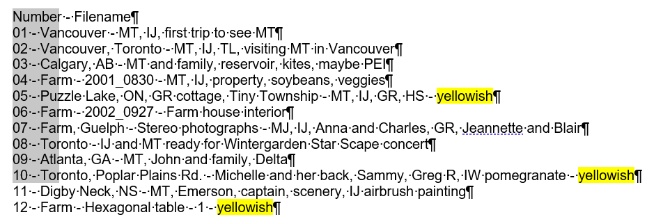

I have a document with 100 lines of text (descriptive filenames, actually) I'm processing the lines for printing and need to replace only the first appearance of the text string " - " (or space-hyphen-space) with a tab. There are other instances of this same text string in some of the filenames, so I only want the first appearance to be found and then replaced with a "^t" character.
However, after I've made my selection (which lamely can only be extended to the bottom of the page, not by dragging to the actual end of the document) and started the Find and Replace operation, Word throws away my selection, creates its own that extends to the entire lines, and then Find and Replaces throughout the entire document.
My original Selection:
Results after Find and Replace " - " with "^t" in my Selection:
As can be seen, Word extended the selection to the end of each line and then did the Find and Replace operation.
This is not what I asked for and I can't find any way to make it do what it should do, which is to only Find and Replace within the selection.

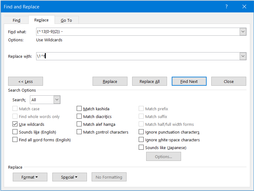

  1. Doug Robbins - MVP - Office Apps and Services 322.1K Reputation points MVP Volunteer Moderator
    2023-01-02T01:33:52+00:00
    Use the following Wildcard replace routine:
    Find what: (^13[0-9]{2}) -
    Replace with: \1^t
