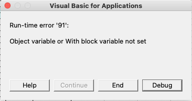

When attempting to run an Excel macro I receive the error message Runtime Error '91': Object variable or With block variable not set.
The macro is not created by me but the source is trustworthy and I know that it works on PC. If shared via OneDrive it works a PC but not on the Mac. How can I solve this?
Thanks!

    I would assume this is the case then, that the code is not compatible with Mac. Are there any guidelines on how to create a code compatible with both Mac and PC?
    Hi Linda,
    No, the problem is generally simple:
    Sometimes you need to do special tasks which are not possible using VBA and/or what Excel provides. In Windows there are many external DLL files, which are libraries that export functions, inside the system folder which we can access / use to do this tasks.
    A Mac does not have this structure and does not provide it because of its security concept.
    Therefore, many things are not possible on a Mac.
    Andreas.
    5 people found this answer helpful.

    Depends on the VBA code... but in most cases the code is not compatible with a Mac and therefore the file is not compatible with your Mac.
    Andreas.

    Hi Linda,
    Greetings! Thank you for posting to Microsoft Community.
    There are two steps to creating an object variable. First you must declare the object variable. Then you must assign a valid reference to the object variable using the Set statement.
    Object variable not set (Error 91) | Microsoft Learn
    Share your code will help to check your issue.
    Best Regards,
    Snow Lu

    Hello Andreas and Snow,
    Thank you for the quick replies.
    It would be great to be able to let the supplier of the code know this so that they instead can provide a file with a code that is compatible also for Mac.
