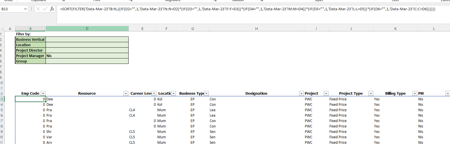

Hi there,
I have the following list prepared
Business Vertical
Location
Director
Manager
Group
I want to use filter formulat to display the values based on the selection from the above lists. These are 5 lists and I want these lists to display the values based on the selection. For example,
If all of these are blank then show all the data, if Business Vertical has some value then it must show based on that only with the rest of the data.
If Business Vertial is blank and Location is filled as Europe then all the data from Europe should be shown irrespective of other values.
But if the Business Vertival and Europe is filled then it must show that vertval from Europe.
Likewise for all the other fields.
Can someone help me with this please?

    =SORT(FILTER('Data-Mar-23'!B:N,((IF(D2="",1,'Data-Mar-23'!N:N=D2)*(IF(D3="",1,'Data-Mar-23'!F:F=D3))*(IF(D4="",1,'Data-Mar-23'!M:M=D4))*(IF(D5="",1,'Data-Mar-23'!L:L=D5))*(IF(D6="",1,'Data-Mar-23'!C:C=D6))))))

    Use if Location = "', True, else A2:A7=G2, Same as others.
    Here is an sample.
    =FILTER(A2:D7,(IF(G2="",1,A2:A7=G2))*(IF(G3="",1,B2:B7=G3))*(IF(G4="",1,C2:C7=G4))*(IF(G5="",1,D2:D7=G5)))

    Here is my code which works with my the first condition only. Rest works with this formula if I keep all the fields filled up. But I want any or all of the feilds criteria to show me results as expected.
    =SORT(UNIQUE(IF(D2="",TAKE('Data-Mar-23'!B3:N1048576,'Data-Mar-23'!BK2),FILTER('Data-Mar-23'!B:N,(('Data-Mar-23'!N:N=D2)*('Data-Mar-23'!F:F=D3)*('Data-Mar-23'!M:M=D4)*('Data-Mar-23'!L:L=D5)*('Data-Mar-23'!C:C=D6))))))
