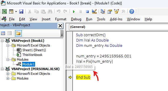

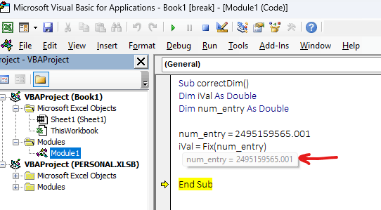

Hi Umut
Please, make sure that the variables iVal and num_entry are correctly Dimentioned
i.e.
Dim iVal As Double
Dim num_entry as Double
OR
Dim iVal As LongLong
For more info please, check the links below
https://learn.microsoft.com/en-us/office/vba/language/reference/user-interface-help/double-data-type https://learn.microsoft.com/en-us/office/vba/language/reference/user-interface-help/longlong-data-type
Regards
Jeovany

    Hi Jeovany,
    Thank you for the fast reply.
    Actually, I had the Dimentioned without "as Double" part. Then, I tried "num_entry as Integer", it didnt work and then I tried "as Double" and worked like a charm.
    Option Explicit
    Dim iVal As Double
    Dim num_entry As Double
