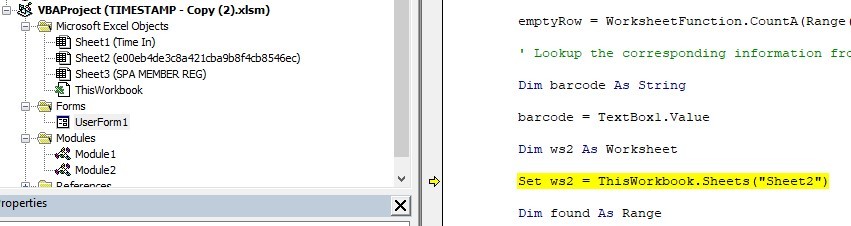

    I keep getting a Runtime error '9' - Subscript out of range
    Could it be because I have a random sheet that I cant seem to get rid of?

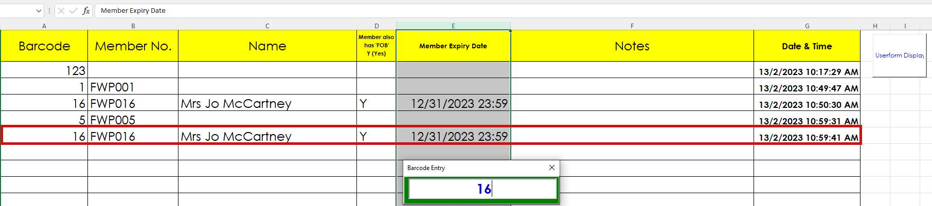

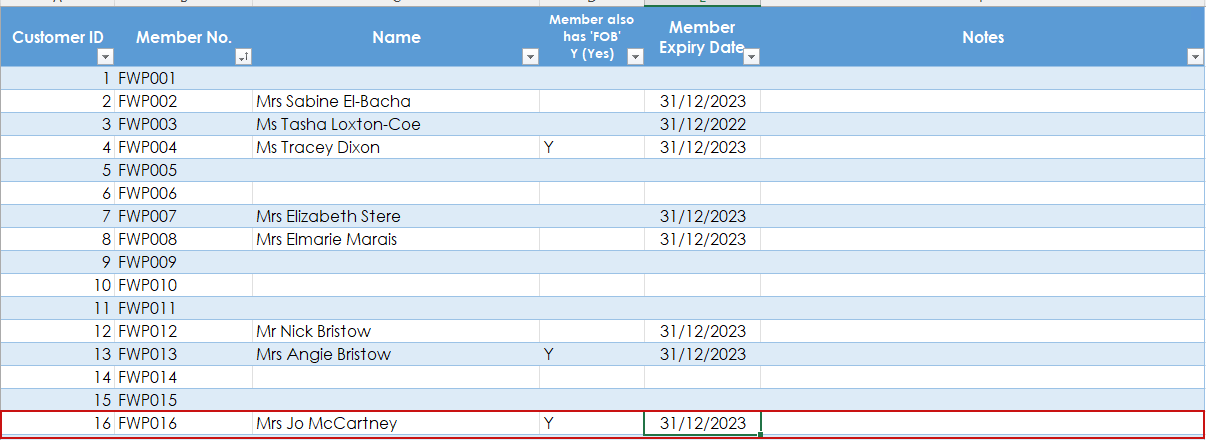

    I have view the sheet 1 and the sheet 2. Here I can see the Barcode and Customer ID. As show shown below:
    If you need to find the corresponding value in the sheet 2, assuming that when you input the value of '123', here I could only take customer ID as your barcode. If you need to change another condition. Just modify the code, here is the result I could make:
    If I input the value of 16 (red box), The following value will be input based on the sheet 2, the 16 in the sheet 2 display as shown below:
