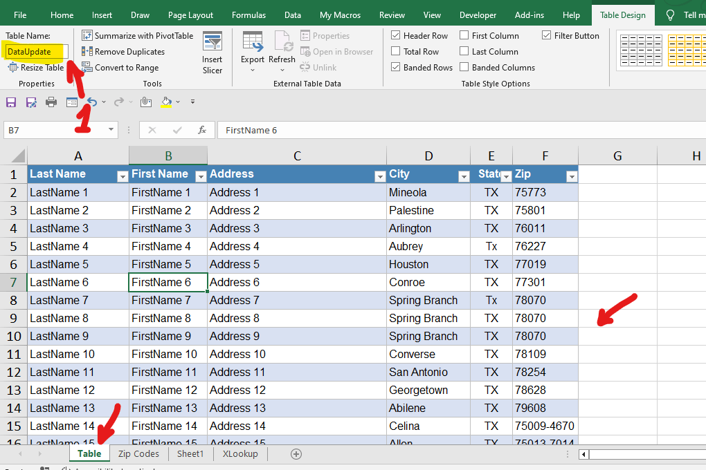

    On the "Table" sheet
    1. We converted the table into an Excel table and named it "DataUpdate"

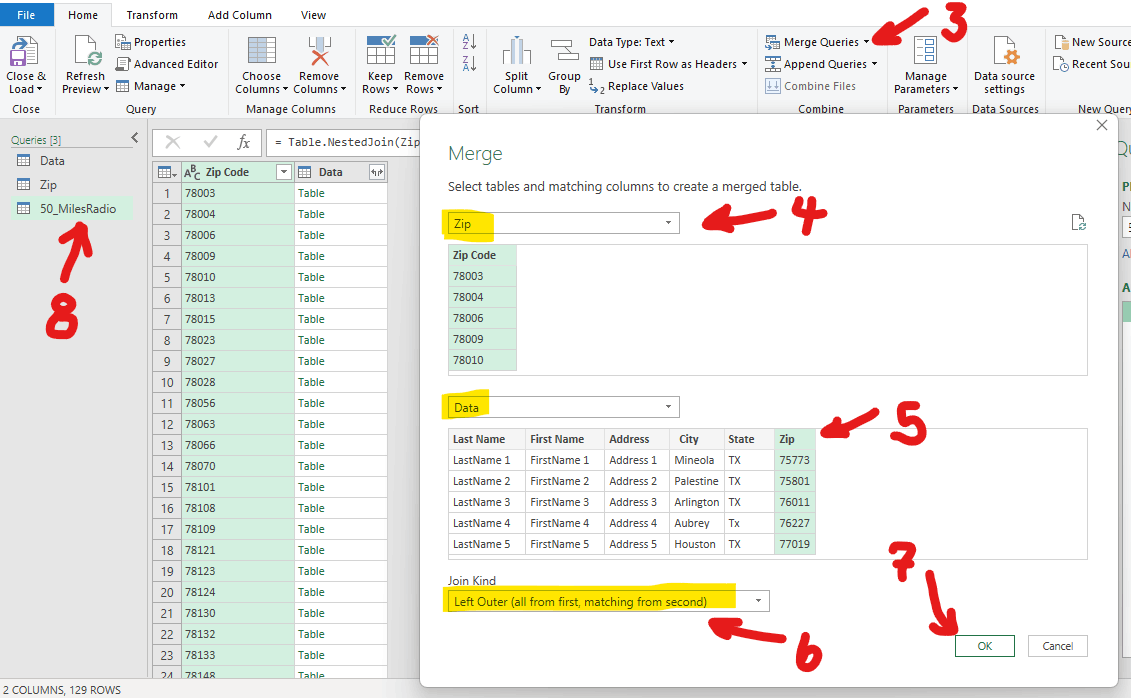

    2. Select Merge Queries >>> New Query
    4 and 5) Choose the 2 tables as indicated in the picture and select the columns to Match in this case the "Zip" column
    6 and 7) Choose the Join Kind as indicated and press OK

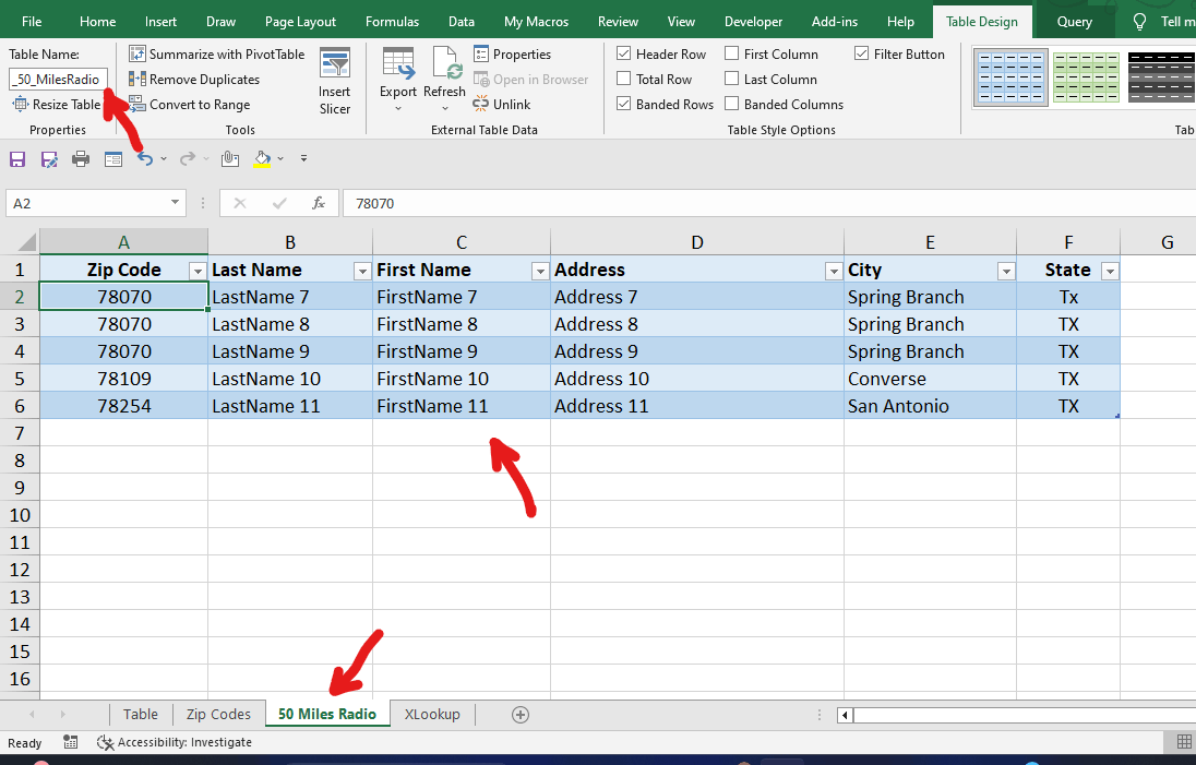

    1. Give/ Rename the Merged table as you like, (eg. "50_MilesRadio")

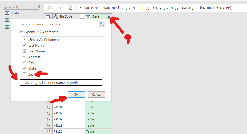

    2. Click the double arrows to expand the Table and uncheck the fields as in the picture below

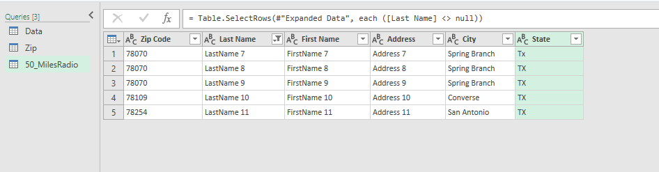

    1. Filter out the null rows, in order to display only the Zip codes with data in it
    And upload the resulting table back to excel
    VOILA!!!

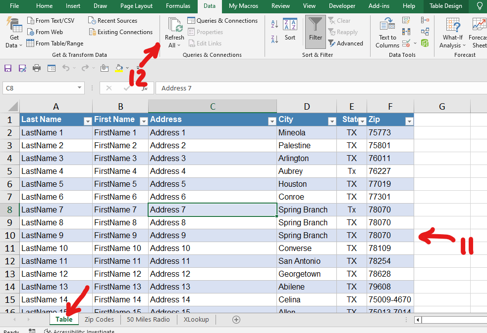

    11 and 12) Replace the sample data with your real info and REFRESH the Query
