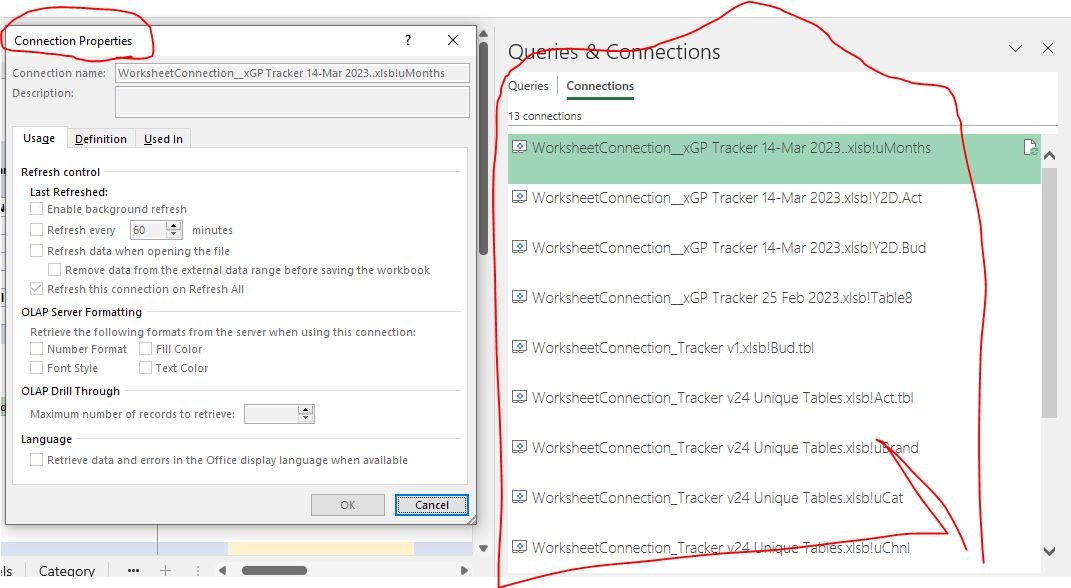

i have excel file which have tables inside then transformed to model to create power pivot, but all from the same file not using other sources from outside.
every update i take a copy of the file and change the name to have the current month name,
today i put data but i see it doesn't reflect on the output then i figured out that in queries and connection pane i have lots of connections to old files.
i tried to change data source by i see in its properties no path to change it as you see in attached picture
any ideas how to make all these connections read from current file data because when i delete them i delete some of the outputs pivots and slicers.

    2023-05-04T19:56:56+00:00
    Hi Anna,
    Thanks for your help, just to clarify i already have add-ins activated and made the whole project fine, but i have no current database connection appear
    in existing connection menu i get all "No Connection Found".
    by the way i have no queries in this file
