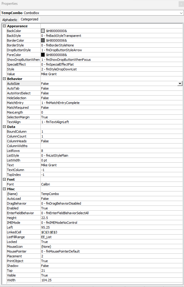

I used a combo box and vba code from instructions I found in order to have my data validation with drop down list autocomplete as I start typing. The code was pasted to the sheet's vba (pasted below). This method converts all data validation lists on the sheet to autocomplete as the combo box. I only want the combo box/auto fill to apply to one specific data validation list. Please help!

Set xCombox = xWs.OLEObjects("TempCombo")

        .ListFillRange = xStr

        .LinkedCell = Target.Address

    Hi Mike G!
    To apply the combo box/auto-fill to only one specific data validation list, you need to modify the code so that it only runs for that specific range.
    First, you need to change the line "If Target.Validation.Type = 3 Then" to specify the range you want to apply the code to.
    For example, if you want to apply it to cells B2:B10, you would change it to:
    If Not Intersect(Target, Range("B2:B10")) Is Nothing And Target.Validation.Type = 3 Then
    This line will check if the current selection is within the specified range and has a data validation list.
    Then, you need to change the line "Set xCombox = xWs.OLEObjects("TempCombo")" to specify the name of the combo box you want to use for this specific range. For example, if the name of the combo box is "Combo1", you would change it to:
    Set xCombox = xWs.OLEObjects("Combo1")
    Finally, you need to modify the line that sets the LinkedCell property of the combo box to use the address of the first cell in the range, rather than the address of the current selection. For example, if the range is B2:B10, you would change it to:
    . LinkedCell = Range("B2"). Address
    After making these changes, the code will only apply the combo box/auto fill to the specified range.

    Change the line
    to
    If Target.Address = "$D$3" Then
    where D3 is the cell for which you want the drop down with AutoComplete.
