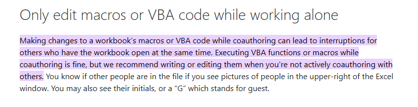

    2023-06-23T14:33:19+00:00
    Can you please clarify
    In the first reply to this thread was a line from
    "Best Practices while Coauthoring in Excel - Microsoft Support"
    that stated:
    "...Executing VBA functions or macros while coauthoring is fine..."
    Just want to make sure that includes all types of macros like Event Macros.
    Please confirm - thanks very much

    2023-06-23T13:04:28+00:00
    Thank you very much
    I have a follow-up question:
    My file contains event macros; for example macros that allow the user to pick more than one item from a data validation drop down list and macros that insert a comment into a cell when a cell's content is changed.
    So just to be sure and clear, are you saying that even with Event type macros like these in the file, executing these macros while coauthoring if fine?
    (I understand to only edit Macros or VBA code when working alone)
    Thank you very much!
    Craig
