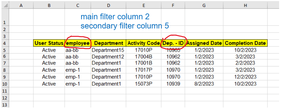

    2023-06-17T14:14:17+00:00
    try this code
    [Update2..]
    Sub SplitData_2Filters()
    '## 17/06/2023 ##
    'use main filter and secondary filter
    Const N As Integer = 4 '<< headers in row 4
    Const fltMain$ = "C" '<<< main filter in column C
    Const fltSecond$ = "F" '<<< secondary filter in column F
    Const ColStart$ = "B" ' data start column
    Const ColEnd$ = "H" 'data last column
    Const srcName$ = "Sheet1" '<<< Source Sheet Name

    sample
    pic1

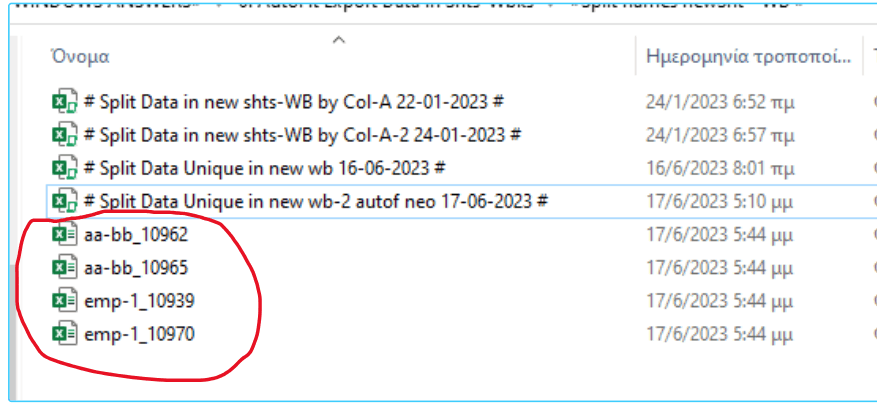

    result
    4 .xlsx files
