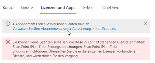

From the old subscription (in grace period) my users have an A1 license with additional M365 Apps.
From the new subscription, they will get an A3 license.
To replace A1 with A3, do I first delete the A1 assignment and then assign A3?
An assignment of both licences is not possible, because of the conflict between SharePoint Plan1 and Plan2. My plan to assign both an then delete A1 is not working.
Right now, all licenses are assigned in AzureAD through a group.

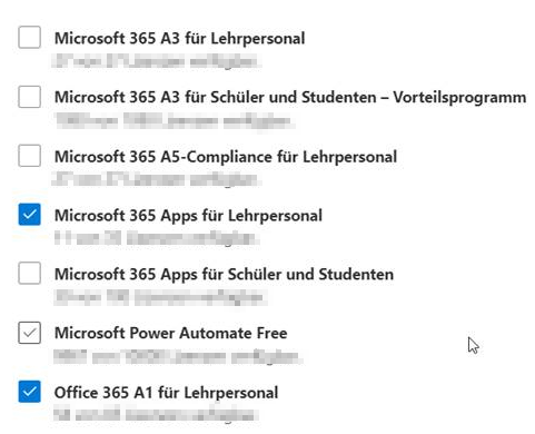

    All new licenses are available as shown in the picture. The group for assigning the license is cloud based.
    Following your description, I wont get in troubles first removing all licenses and then assign the new ones.
    Maybe I remove first one user from the group - remove his license and try to add the new one before doing it in bulk.
