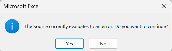

Now that I know that the formula works I want to add it to a cell's data validation, as a list, but when I enter the formula above I get an error

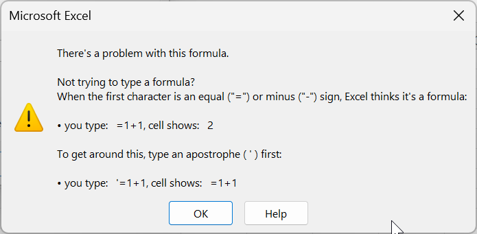

So I enter the formula as
=INDIRECT("OFFSET(SERVICES!$B$1,MATCH(Packages!A2,TableServices[Packages],0),0,COUNTIF(TableServices[Packages],Packages!A2),1)")
But then it displays the message
If I continue, there is no Data Validation on the cell.
When it is trying to validate the formula I can see that it throws the error having located the correct multiple rows as it highlights the selection and then stops.

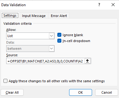

    Change your table reference to range reference, then it will work.
    In sheet services,
    =OFFSET(B1,MATCH(E7,A2:A53,0),0,COUNTIF(A2:A53,E7),1)

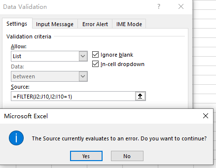

    The issue is caused by your formula result is an array instead of a range and the data validation list can only accept range.

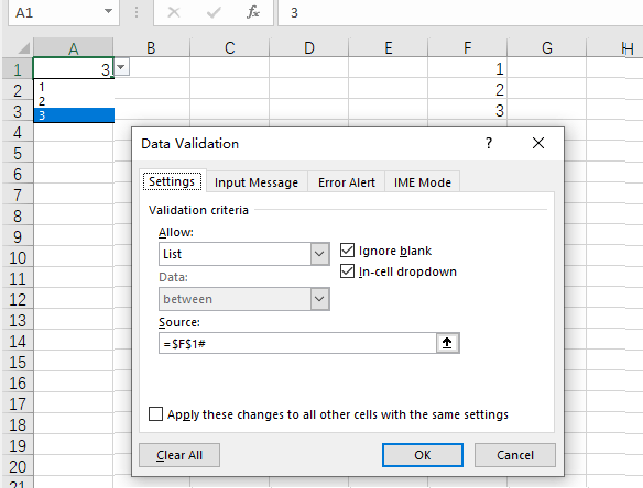

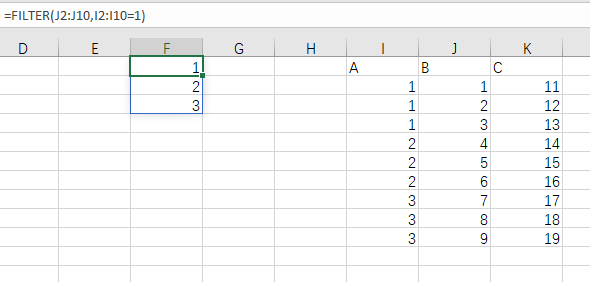

    You can put your formula result in another cell and use that range as drop down list.
    For example, if you put the filter formula to a data validation list. It will get the error.
    If you use =F1#, it will work.
