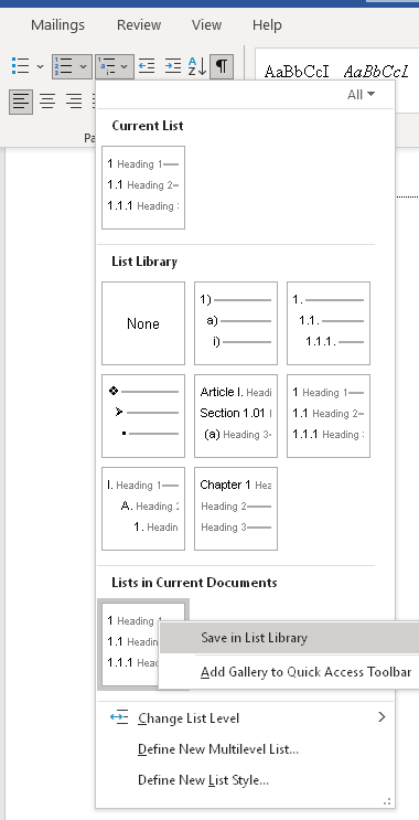

I want to modify the list style I have setup for my headings. However, when I go to the multilevel list dropdown menu and right-click on the list style I do not get a modify option! See image below. I tried right-clicking on the Heading list both under the List Library and under the Lists in Current Documents, neither produce a modify option. Unless I am misremembering, this is how I always used to modify list styles.
How can I modify an existing list style? Thank you!

    You are correct, there is no modify command. The only way I know to do this is to be in a level one paragraph and use the Define New MultiLevel List dialog. It will start with the current list and let you make modifications. (The single-level list dropdown does have a Modify command, but does not work on a multilevel list and even fyor a single-level list may be that dialog to use because it has so many more formatting controls.)

    Thank you for your reply! In most documents what you suggest works, and so definitely helps. However, I have one document where the list style somehow got detached from all of the heading styles! Since that list style has no paragraph/text style associated with it, I can not find a way to get in to modify the list style to fix the problem. I am sure I have had this happen before, and almost sure I fixed it by right-clicking on the list style and and selecting an option to modify the style. But that option seems to have vanished?!! But I can't think of any sane reason to remove it?

    This eventually worked, thank you! I managed to apply the list style to some random text by highlighting some text and clicking on the style from the List Styles section of the multi-level list menu. This isn't how list styles should be applied, I know I should just apply them to styles and then use the style gallery to format my text. But it did let me get in and edit the list style. Once was in to edit it I was able to re-apply the list style to the headings and fix everything.
