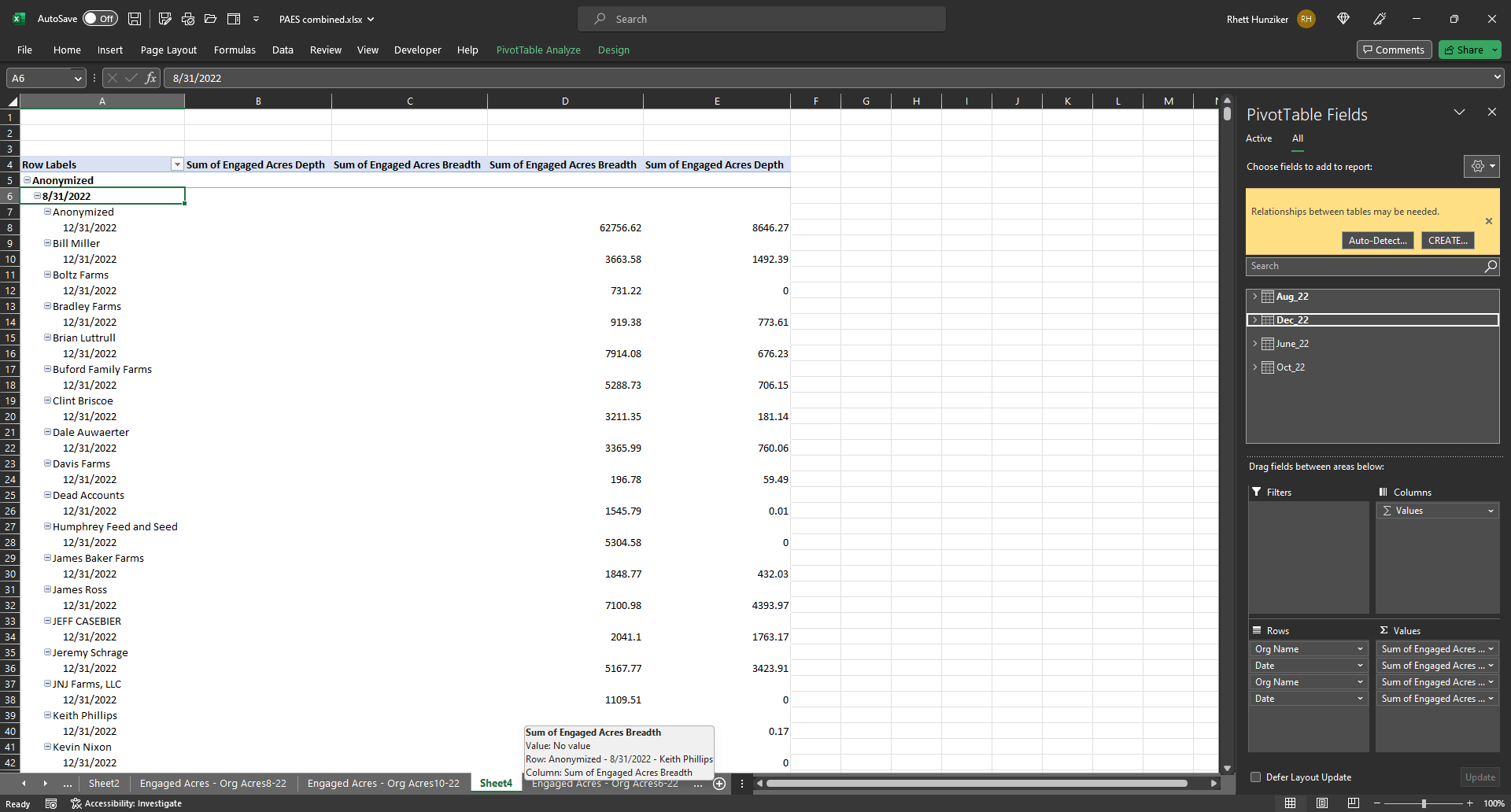

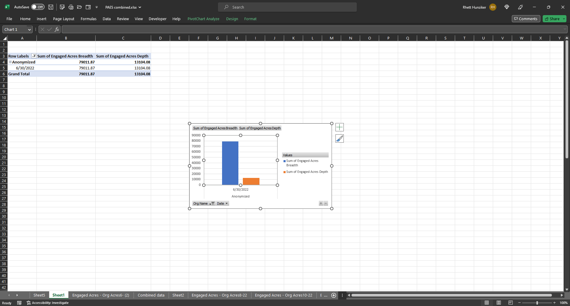

I've got multiple sheets that contain data for 2 similar products. Each sheet is also a different date with customers that may be repeated due to various regions. I've tried doing a combined pivot table. That works for combining the customers, but I haven't been able to get the data to separate by date as well. I've tried to work with combining graphs with no luck. Below is an image of what I'm going for. It's a chart from a pivot table for a single date. But I'm having no luck on a combined pivot table.
Here is what happens when I try to add multiple data sources.
