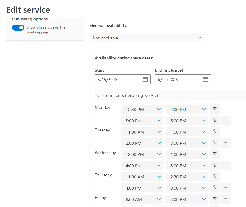

I'm running into issue setting custom hours for a service on MS Bookings. It'll only be for 1 week, so I set general availability on the Edit service page/Availability options for "Not bookable" and then added the "Availability during these dates" option with custom hours. Most days include multiple time ranges (e.g., 12:30-2 p.m. and 3-5 p.m.).
The public bookings link reflects the custom date range, and the starting times reflect the custom start time for each day. However, every day displays continuing options up to 8 p.m., even when the custom time ends earlier. The multiple time ranges in a day are also not reflected in the available bookings: They all begin at that day's custom start time and run through to 8 p.m.
On the Booking page, I've tried setting general availability both as "Not bookable" and "Set different availability for a date range" with the custom times. Neither of those affects the issue for the service. I've also double-checked to ensure that the time zone is correct.

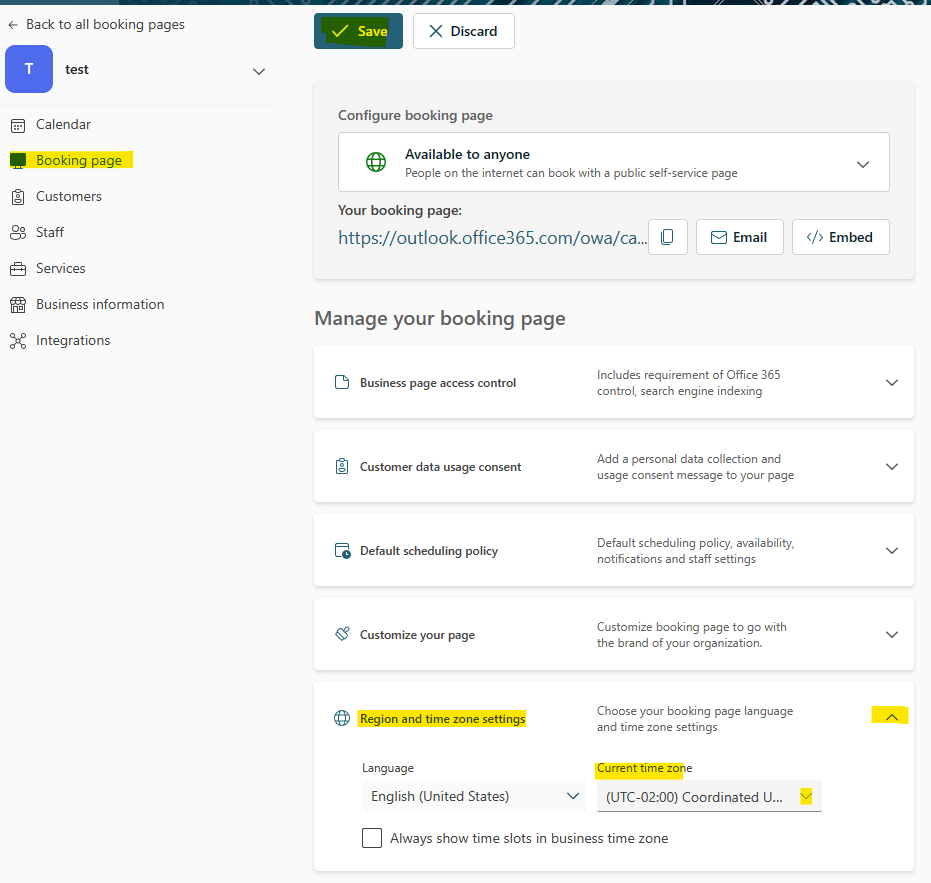

    Here's the time zone setting on the general Bookings page:
    Here's the availability for a particular service:

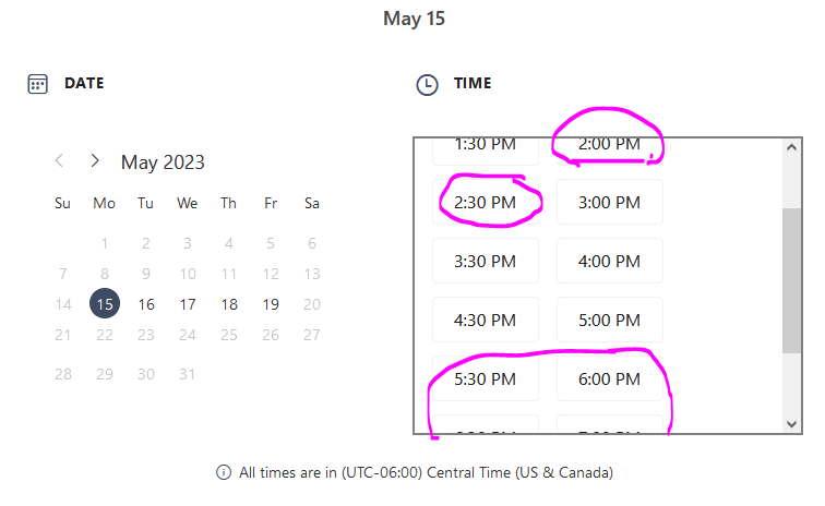

    And here are the time slots that show up when I click the service booking page link. I've circled the slots that should not appear, based on the time settings for May 15 (they run until 7:30 p.m.):

    • May I please double confirm if your public bookings link time zone and your Booking page time zone is same? if you haven't check it yet, please kindly Open your Microsoft Booking --> go to Booking page -->Expand Region and time zone settings --> Under Current time zone, check if it is same time zone with your public booking link time zone, if it has difference, please kindly change and Save. then try if there is any update. You can refer to the screenshot.
