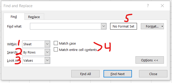

    The solution is probably in the options in the Find/Replace window. When you click on Options it opens up additional choices for how to search. Make sure that:
    1. You are searching on this sheet.
    2. You are searching by rows.
    3. IMPORTANT: If the data is the result of a formula that you have selected values.
    4. That the Match Case and Match contents boxes are not checked unless that is what you want.
    5. That the format option says No Format Set. If it says anything else, use the Format dropdown to the right and click on "Clear Find Format".

    2023-03-22T12:15:45+00:00
    Yes, I have checked/ done all of those things and it still will not work.

    2023-03-22T12:19:51+00:00
    My computer had an update this morning and now it works. Thanks for the help.
