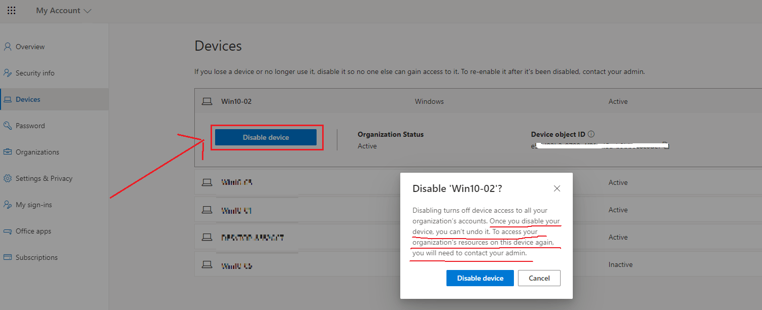

Mistakenly i disable the device by clicking lost the device and now my Microsoft apps not working on desktop. Can anyone help in order to enable it or how we can contact the admin?
If you lose a device or no longer use it, disable it so no one else can gain access to it. To re-enable it after it's been disabled, contact your admin.

    May I confirm if you disabled your device from https://myaccount.microsoft.com/device-list page?

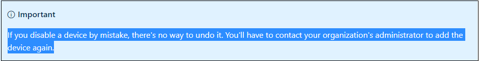

    When we disable a device, we disable the access of all organization’s account on the specified computer. If you disabled a device by mistake, there's no way to undo it. You'll have to contact your organization's administrator to get the bit locker key and enable the device again.
    Unfortunately, a user with no admin access cannot enable a disabled device because the device has to enabled from Azure Active Directory admin center and only admins have the access to this page.
