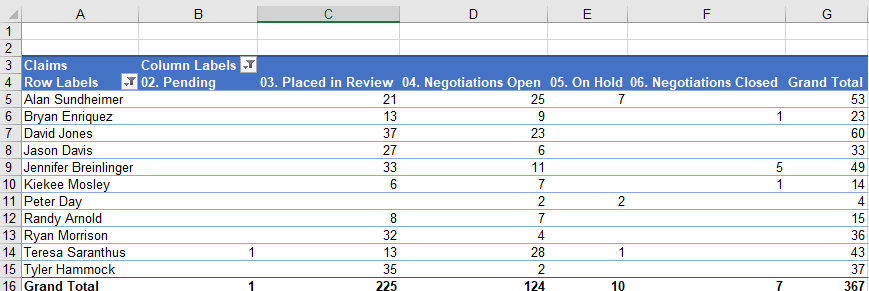

Hello,
I have a macro that creates a pivot table from data that could change in size. I will post the code at the bottom.
I need to add code that would create detail sheets from each row in columns C & D (avoiding the total row in 16). Any help would be greatly appreciated.
I would like the names of the detail sheets to be the name of the person (Alan Sundheimer, Bryan Enriquez, etc.) Since I'm creating two detail sheets for each person, the second detail sheet could add a 1 to the sheet name (Alan Sundheimer 1) or anything that distinguishes it from the other one.
Here is the pivot table:
Here is the code that creates the pivot table from the data:

    2023-01-16T17:08:59+00:00
    The link to the file is: https://1drv.ms/x/s!AqI2uIovxYp5-hwV2ewSQ7l2iJxy?e=EtZsZd
    The pivot table cells marked in yellow and orange are the ones that I want to create detail sheets for. I created the first yellow and orange detail sheets.
    The new detail sheets should use the same name as in column A (colored in green). Because there are two detail sheets (yellow & orange) associated with the same name (green), the second detail sheet's name should add a 1 to the end of the name.
    Because there are 11 names (green) in the pivot table and each has 2 detail sheets, there should be 22 detail sheets when done.
    The code to make the pivot table from the source data (in the JobList sheet) is called "InsertPivotTable".
    I hope that this makes sense.
    Thanks in advance for looking into this.
    Andy
