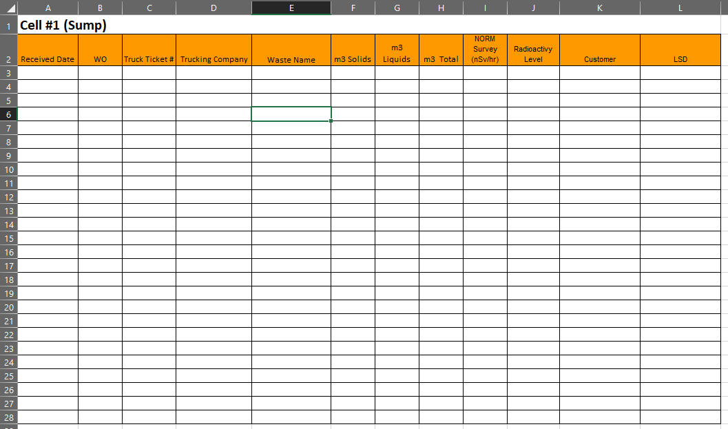

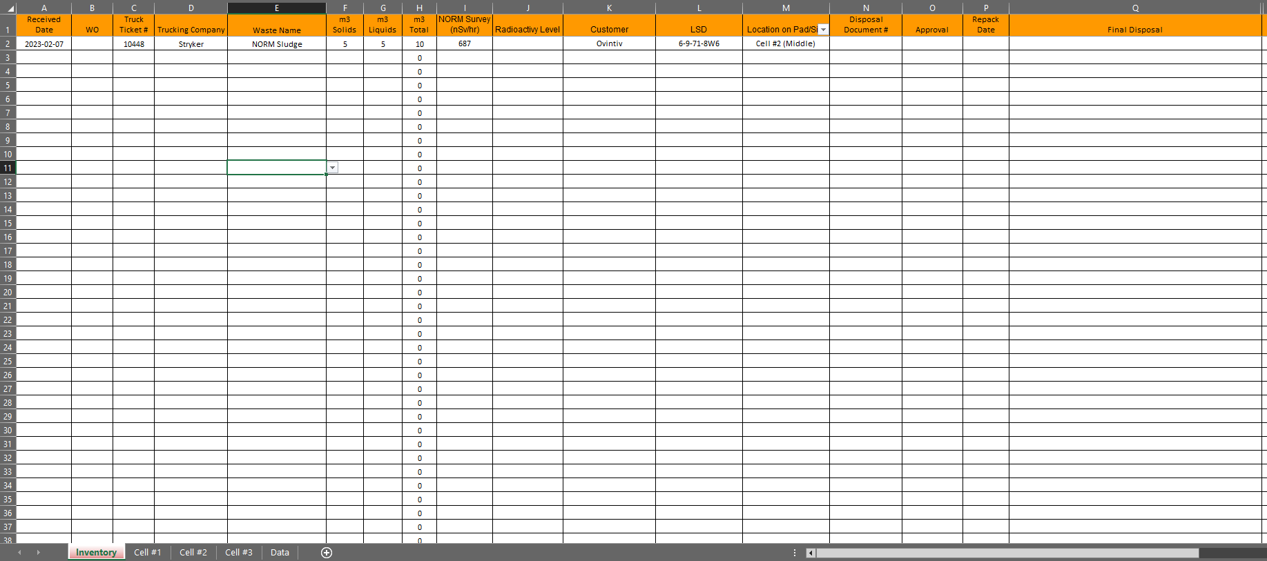

hi there. im really new to excel and not sure where to begin on what i am trying to accomplish.. I’m looking to have my spreadsheet automatically pull the data from “Inventory” tab into “Cell #1, Cell#2 or Cell #3” (all of which contain the same information from column A-L) tabs based on which of those 3 cells is selected from the “Location on Pad/Site” cell. I would also like it to remove the data from the tables in “Cell #1, Cell#2 or Cell #3” once I have selected anything in “Final Disposal” (contains 4 different locations) cell in the “Inventory” tab.

    Hi Anna, thank you for your input and prompt response!
    unfortunately i am still quite new to excel and formatting so i am struggling to figure out how to apply what youve mentioned above to my data.. im hoping that once the sheet recognizes information that should be in Cell #1, #2 or #3 that it will duplicate this information over automatically. and then once the disposal drop down is selected that it will clear the information from the main inventory screen..

    2023-02-14T21:07:03+00:00
    Hey Anna, thanks again! so much detail and help (almost too much for this newbie! lol) i can get as far as step 7/8 then i am unable to get the formula to communicate properly with my sheets.. any chance that excel has a template somewhere that i could use in place of this? i havent been able to find one online myself..
