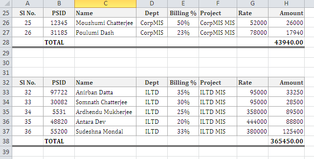

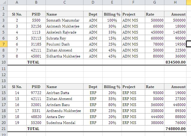

pls consider the following detailed Report for billing :
Now, management required a summary report , the figures of the same should be linked with the detailed report . The summary report should look like following :
However, the following Sub Procedure created by me was running successfully with a limitation that the figures are not linked with main data. The code of the same is as follows:

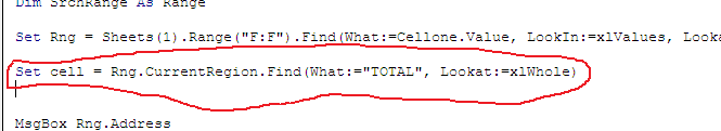

The above function code is not working and producing "#VALUE" . However, I have examined that the following line item (circled in Red) NOT Working in Function code :
Pls let me know what changes to be done in the function code so that the same runs successfully.

    The function is expected to return a value of type Long, but the cell object may not be found, and in that case, its Offset property will return an error. You should add error handling to ensure that the function returns a value only when the cell is found. You can use the On Error Resume Next statement to skip over any errors and return a value of 0 in case the cell is not found.
