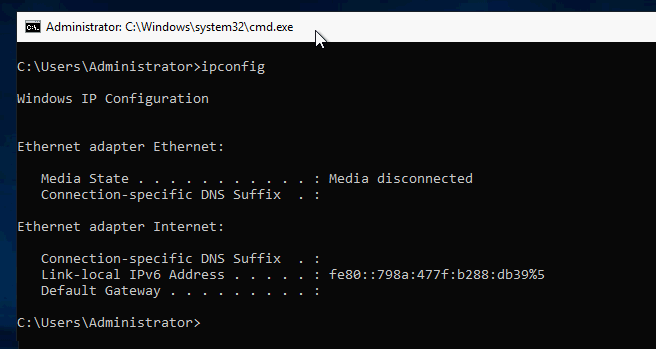

Windows OS's do not suppport RFC3021 officialy. For example DHCP client dosen't work with the above subnet:

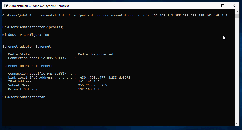

Setting this example address via netsh - no problem:
