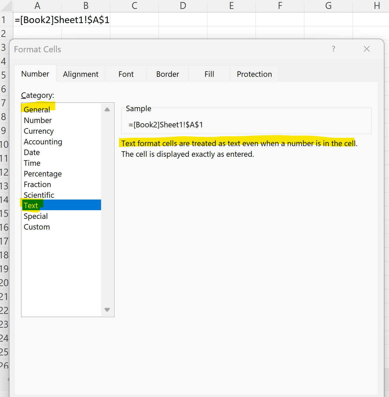

    Hello there,
    I hope all is well!
    Does the relevant cells have formatting set to 'Text'? If so, maybe try changing the cell formatting you have the formula in from 'Text' to 'General'. You can check by selecting the relevant cell(s) and pressing and holding together Ctrl + 1 to bring up the 'Format Cells' dialogue box. If this is the case, change the format from 'Text' to 'General'. Once this is done, you can select the cell and press the function key F2 to click into the cell and then Enter to ensure the contents is refreshed after applying the new formatting.
    I hope this helps!
    With kind regards,
    Judith
    28 people found this answer helpful.
