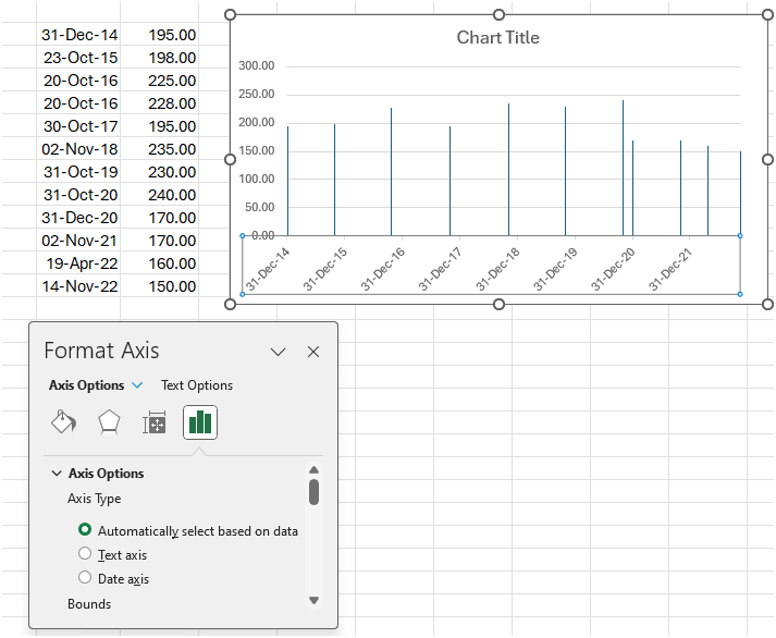

Hi, I have bought quite recently Microsoft Office Home and Student 2021 at home which gives me trouble with bar charts.
For some reason my Excel is not plotting bar charts but chart shows up with vertical lines. Same thing if I choose horisontal bar chart, no bars but horisontal lines. I have understanding that there isn't setting for bar width, well at least I couldn't locate such a setting by my 25+ years experience with Excel.

    Excel assumes you want to plot the horizontal axis as a date axis. Since you only have 12 data points over an 8-year time span the horizontal axis can hold almost 3000 data points. Then, the columns for each of the twelve plotted becomes very small. See picture.

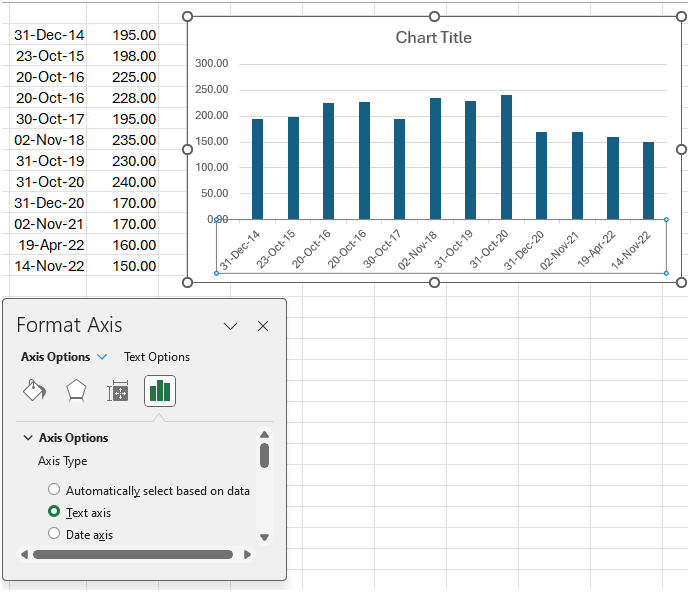

    Change the format of the axis type and set it to "Text axis" and you'll plot 12 same colored columns evenly spread in the chart area.
    Edit: I had not seen the example data you provided nor your latest post where you discovered the Text axis option, until after I posted my answer. You can plot the x-axis in reverse order as your data starts with the most recent date at the top.

    Maybe I wasn't clear enough, I tried to explain problem is visual, bars appear as thin lines. Length of the thin line is correct and according to data. Latest Office updates are applied to 2021 version.
    Now for some reason inserting capture picture of the chart is possible, yesterday it didn't work.
    Here's example chart that I made for water consumption:

    1. No impact at all no matter how I change bar overlapping or gap width settings between -100% to +100% and mixing negative and positive values.
    2. No hidden dates, data is inserted manually to blank excel sheet
    3. According to Office when I check updates, I'm having the latest update up and running.
    Interesting is that if I plot data as individual values (not series) then I get it bars correctly out. 🙄
    But I visually this hard to read, you need to pick color and check what date it is matching and the order is not in chronological order but in the table order top-down ...
    LOL, I could change color to be the same for all and then reading the data from graph would be even harder.
