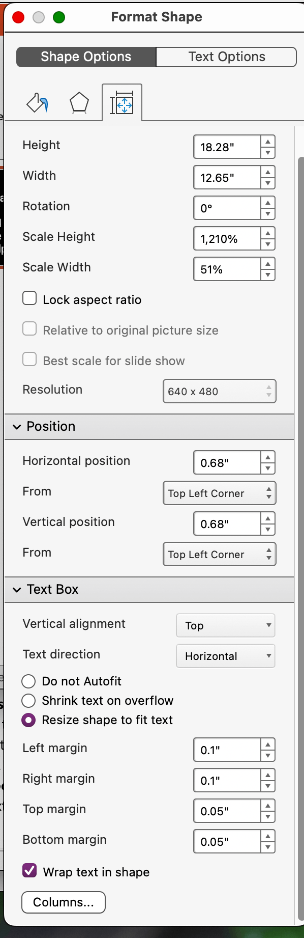

    Right-click on the border of the text box and choose Format Shape. I found these settings appropriate for the amount of text I planned to use. VERY important is to check the box for Wrap Text in Shape.
    Type or paste the text you want to be read aloud into the text box. Adjust the position and size of the text box so that the top of the box is at the top of slide and the width is the same size as the slide area. Text can be and most likely will be past the bottom of the slide as much as you want.
