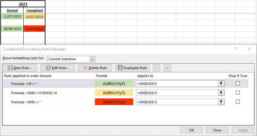

    Remove the existing rules.
    Select H8:H13
    Create a rule with formula =$H8<>"" and red as fill colour.
    Create a second rule with formula =$H8>TODAY()-14 and orange/amber as fill colour.
    Select H8:I13.
    Create a rule with formula =$I8<>"" and green as fill colour.

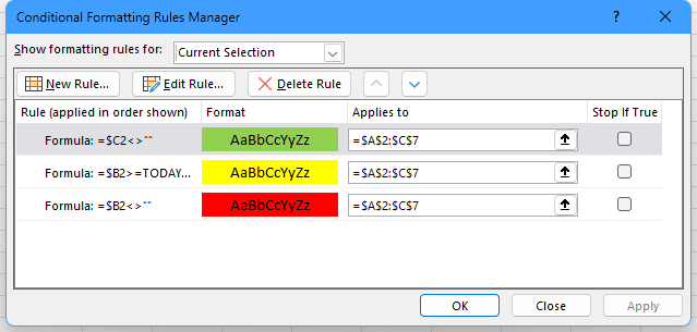

    I'd use two columns: one for the start date and another for the end date. Not only will this make the coloring much easier (it can be fully automatic), but it'll give you a better idea of how long jobs take.
    In the screenshot below, I have created three conditional formatting rules.
    The rules are all of type 'Use a formula to determine which cells to format'.
    The rule created first (listed at the bottom in the screenshot below) uses formula =$B2<>"" and red as fill color.
    The rule created second (listed in the middle) uses formula =$B2>=TODAY()-14 and yellow as fill color.
    The rule created last (listed at the top) uses formula =$C2<>"" and green as fill color.

    Hi HansV,
    Thank you for your answer. Unfortunately, this didn't achieve exactly what I wanted. Please see screenshot below of the formulas entered the same as yours and the results.
    I am hoping to achieve the following:
    • When no date is entered, the cell should remain with 'no fill'
    • When a date is entered in the 'started' column (column H in my worksheet), and it is less than 14 days before todays date, it should be highlighted in yellow
    • When a date is entered in the 'started' column and it is more than 14 days before todays date (i.e. I have been working on it for 2 weeks), it should be highlighted in red - notifying me that it needs to be followed up
    • When a date, any date is entered in the 'completed' column (column I in my worksheet), it should default to green and should also change the colour in the 'started' column (from either red or yellow) to green.
    Hopefully this makes sense what I am trying to achieve. Please let me know if I made any mistakes entering the formulas you have already mentioned.
