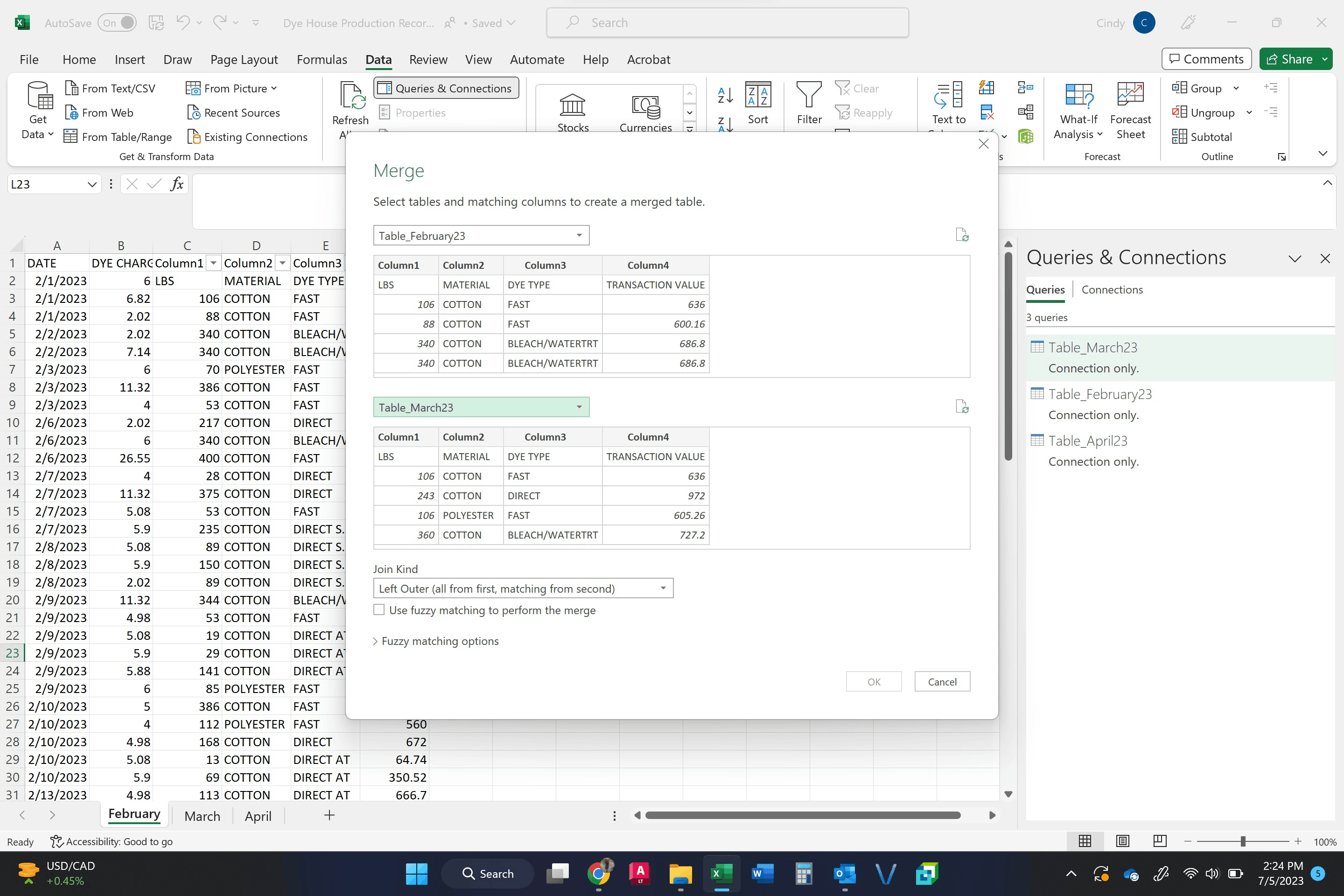

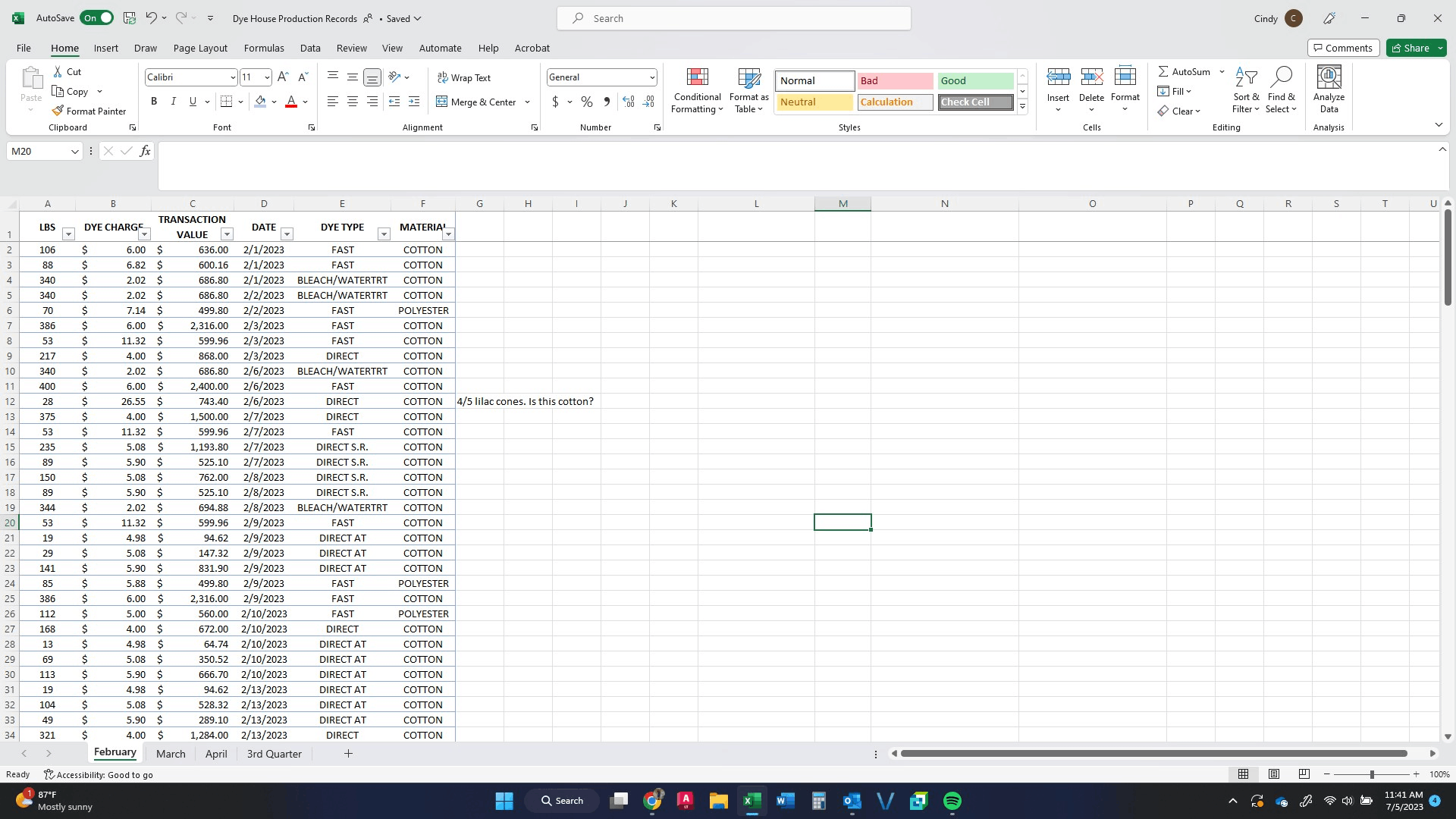

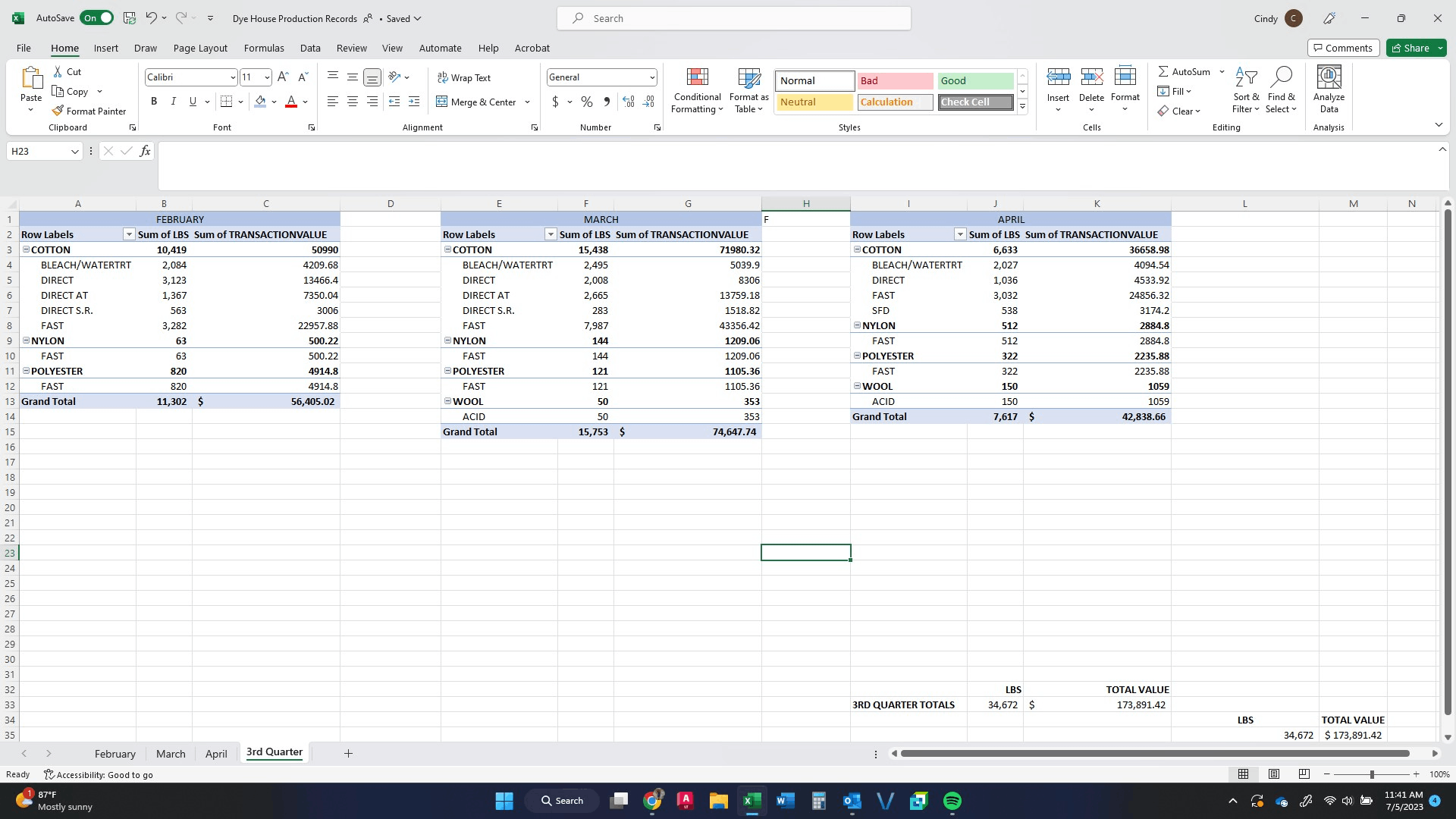

Hello, I have been trying to find an existing discussion to help me out but I'm struggling to find an exact example. I have a table for data that is entered each month. Each table has the exact same headers, but different info is filled in each month. I would like to see a summary for each month ( which I am easily able to do with a quick pivot table) each quarter, and then a yearly summary. Can I create pivot tables like the existing monthly pivot tables shown in the second photo for the quarter and year? I saw on another discussion that you can make Queries and then merge the two, but this looked like it would only be used when two tables weren't exactly the same and you just wanted to include another column from a separate table to your original table.

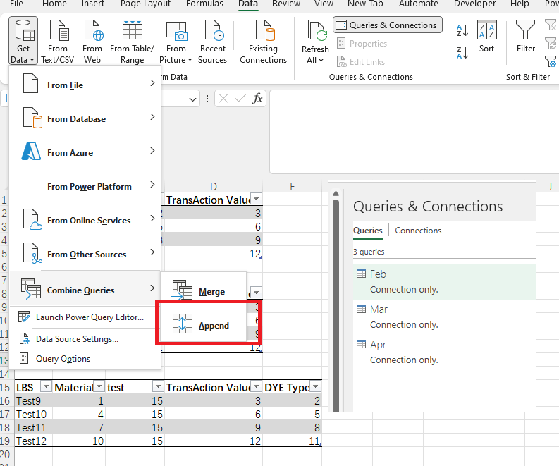

    1. use Append.

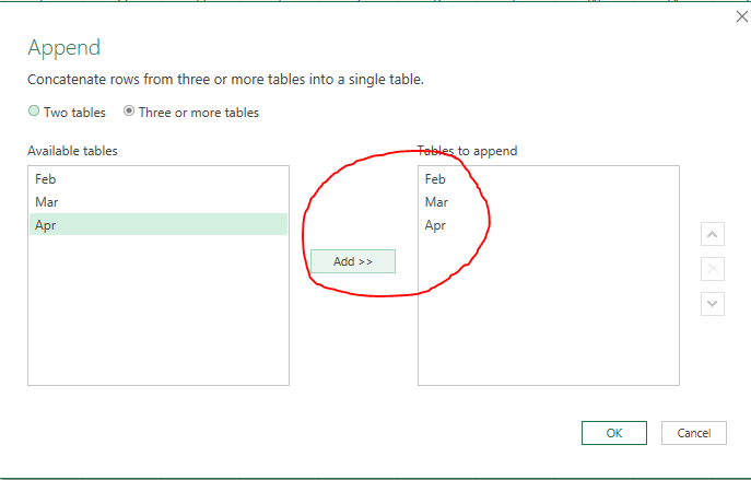

    1. add table

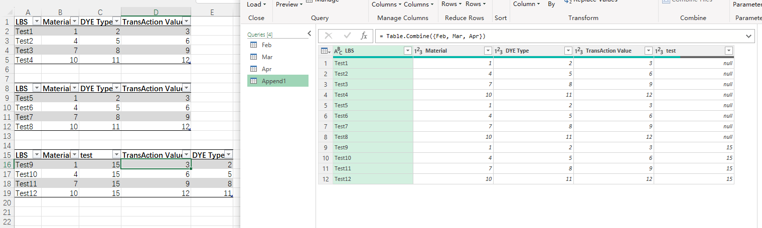

    1. Here is the result.

    2023-07-05T18:25:55+00:00
    'm not very familiar with Power Query. Can you walk me through a few steps? I tried following these instructions https://www.ablebits.com/office-addins-blog/excel-join-tables-power-query/ but I got stuck while trying to merge the tables.
