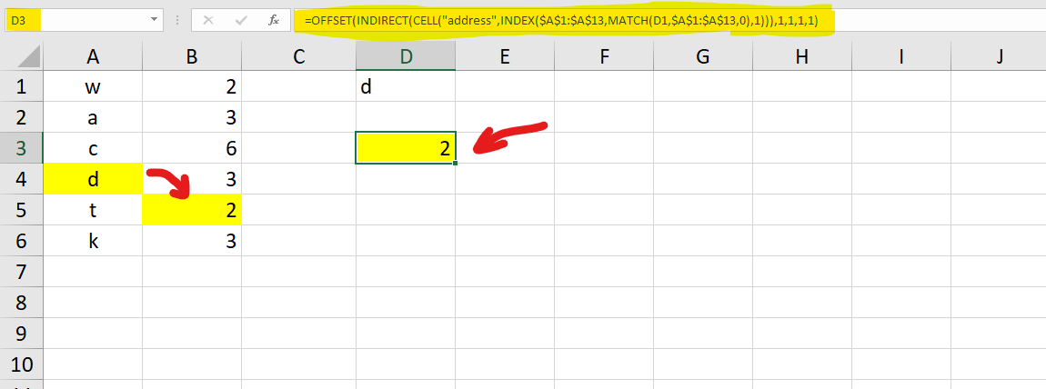

    2023-11-06T21:13:07+00:00
    After some thoughts
    The CELL() function returns a cell address as a Text value, hence the error. To convert it to a reference we need to wrap it with the INDIRECT() function.
    Following the details in your picture, here is a working formula
    =OFFSET(INDIRECT(CELL("address",INDEX($A$1:$A$13,MATCH(D1,$A$1:$A$13,0),1))),1,1,1,1)

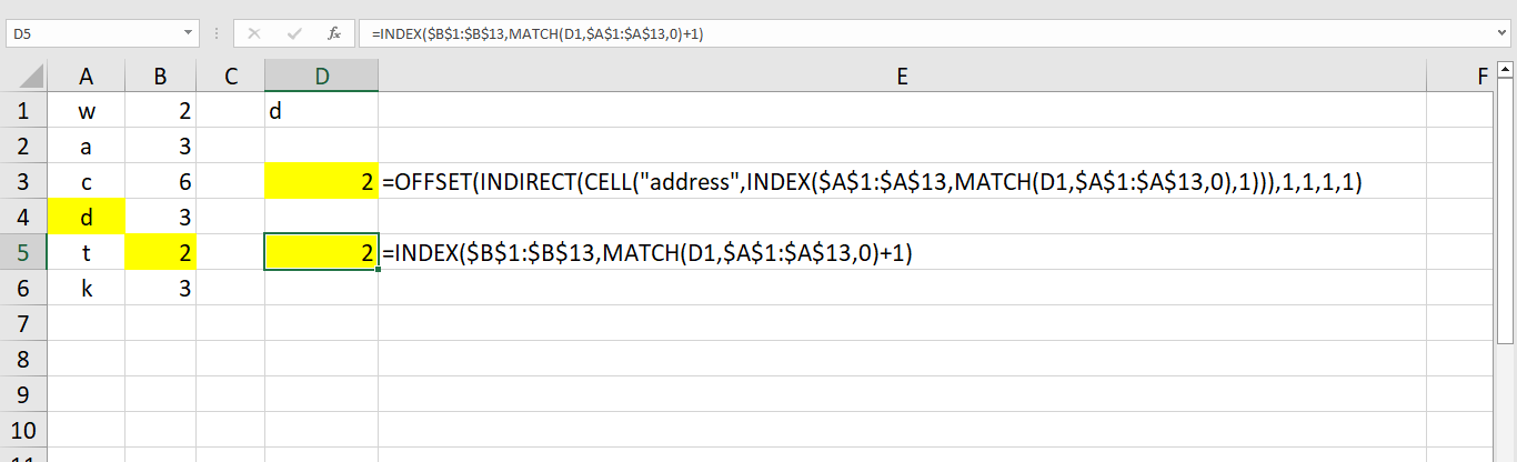

    Note:
    If your goal is to return the value one row below, one column next to the matching criteria (cell B5 in the picture above) then you might consider NOT using volatile functions like OFFSET(), CELL(), and INDIRECT()
    Here is an alternative formula for equal result =INDEX($B$1:$B$13,MATCH(D1,$A$1:$A$13,0)+1)
    I hope this helps you and gives a solution to your problem
    Do let me know if you need more help
