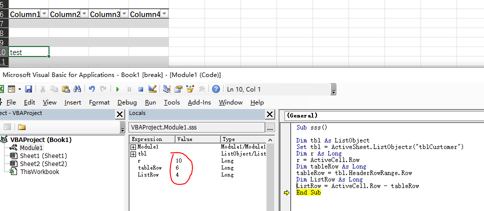

I'm trying to refer to the current row in a table but whatever I try, nothing works. I understand that the table model doesn't have a direct route to the information.
My issue is that whatever I plug in here, the result for ListRow is 0.
Dim r As Long
r = ActiveCell.row
Dim tableRow As Long
tableRow = tblCustomer.HeaderRowRange.row
Dim ListRow As Long
ListRow = ActiveCell.row - tableRow

    2023-11-29T03:23:24+00:00
    What do you want to do next?
    r=10
    TableRow=6
    ListRow=4
