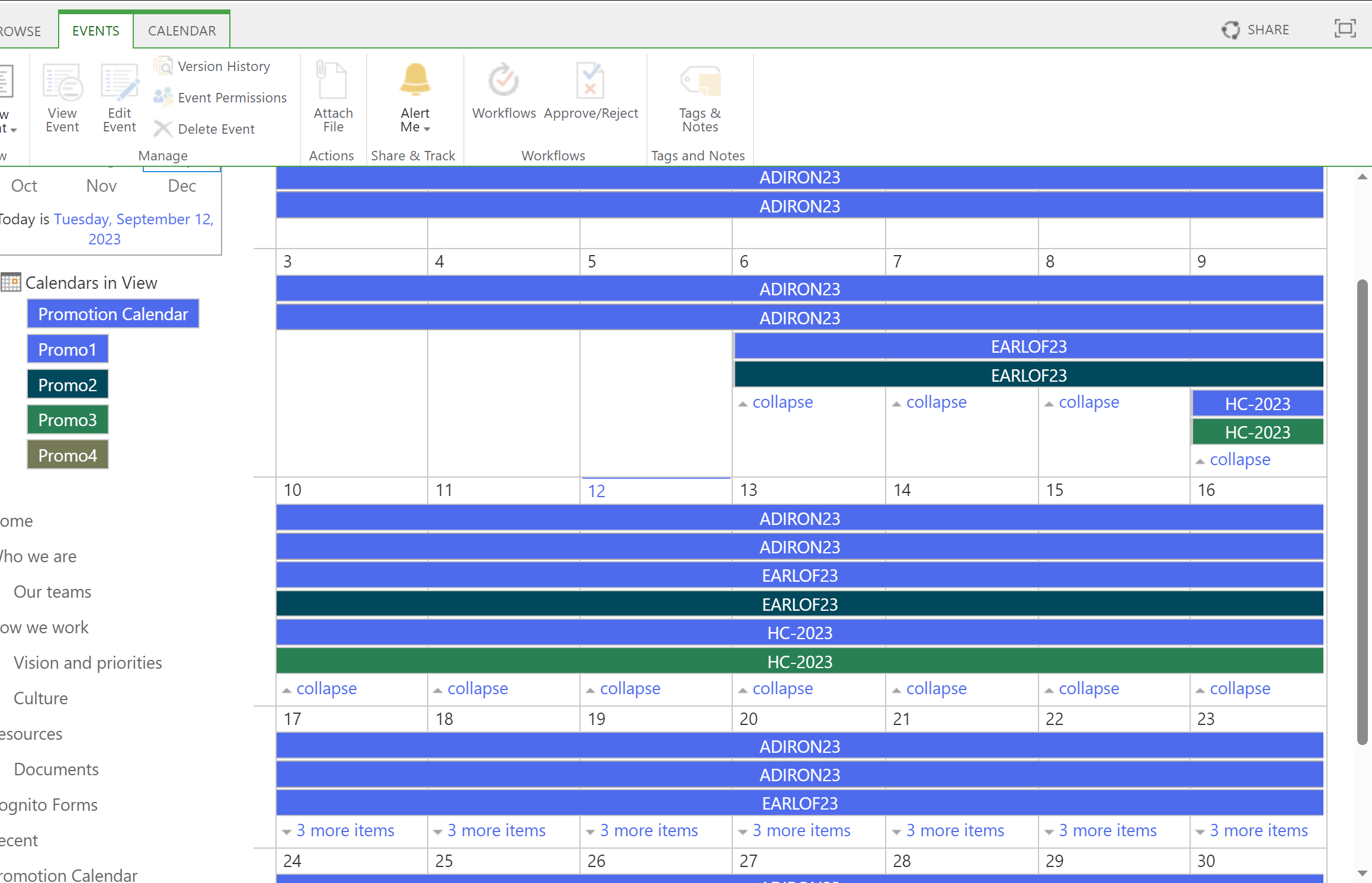

The resolution in this thread does not solve my problem, however. If I follow the instructions from the previous thread solution, I am left with every event having every color:
Does anyone know why MSFT makes this so challenging? To accomplish the above I spent several hours researching/watching videos, and had to set up a dozen views for reasons I don't understand. I am not sure what a view is, and why I have to create multiple ones to get different colors to work. Why can't we just create categories and color code them as in Outlook?

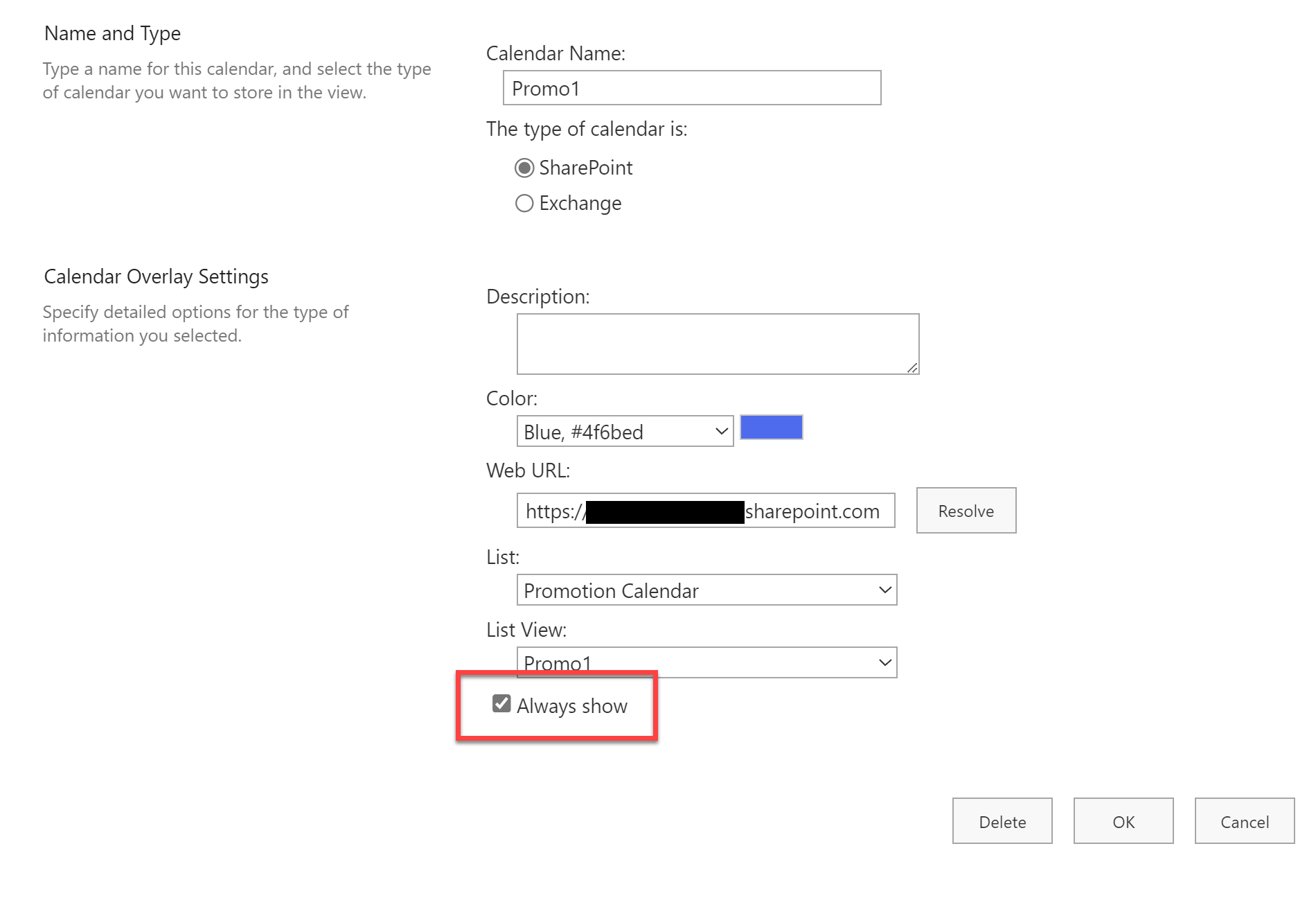

    Figured it out. The issue was the primary calendar was set to always display.
    Once I turned this off, everything worked as desired.

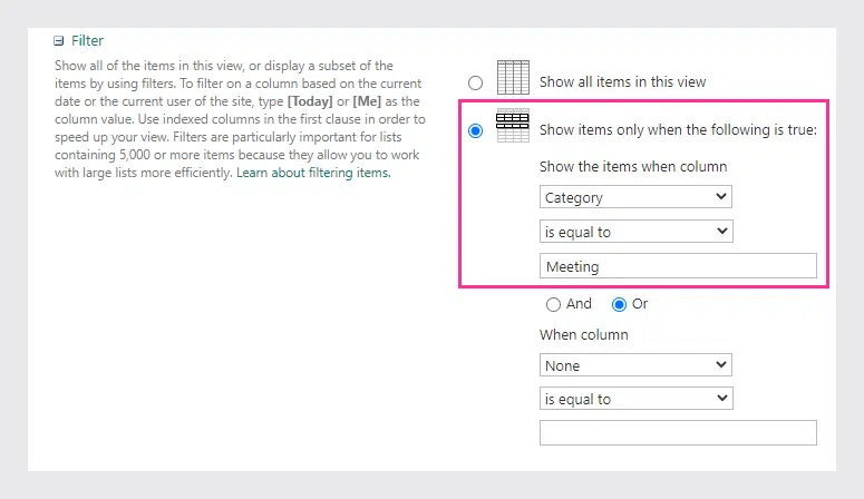

    Found this which helped me separate the events:
    However I'm still seeing multiple versions of each calendar event. How can we limit this to just one instance per color/event?
    Each of the below should have one item/band/instance:
