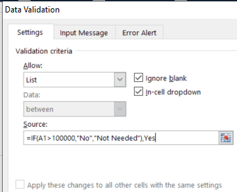

I've tried looking up various solutions but none seemed to be what I need (mostly nested dropdowns). PLEASE NOTE: I am unfortunately using Excel 2013. I have tried putting the IF Function directly in the data validation source data but it just gives me the formula as one of the drop down options and doesn't actually change based on the IF formula. e.g.:

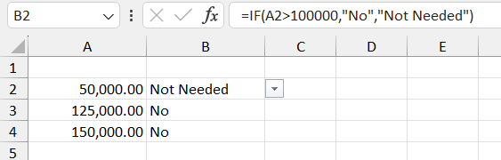

    It may be possible to set this up with sheet code, but I will address it on a formula level. I used Row 2 since that is the first row of you sample data. In Row 2 of your column Analyst Confirmation, enter this formula and drag down:
    =IF(A2>100000,"No","Not Needed")
    Modify this according to your actual data. In your sample the Amount is actually in Column B it appears. This will fill in the initial information based on the Amount in the chart.

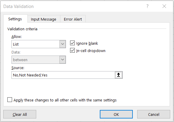

    For the Data Validation, enter the three options in the Data Validation window as below.
    The Analyst will be able to override the formula and enter Yes when they have entered their comment. The drawback, that sheet code might be able to correct, is that when the Analyst enters Yes in the cell the formula will be overwritten and deleted. You currently have the macro to reset the sheet to No, so you should be able to revise that macro to put the formulas back in place to reset the form.
