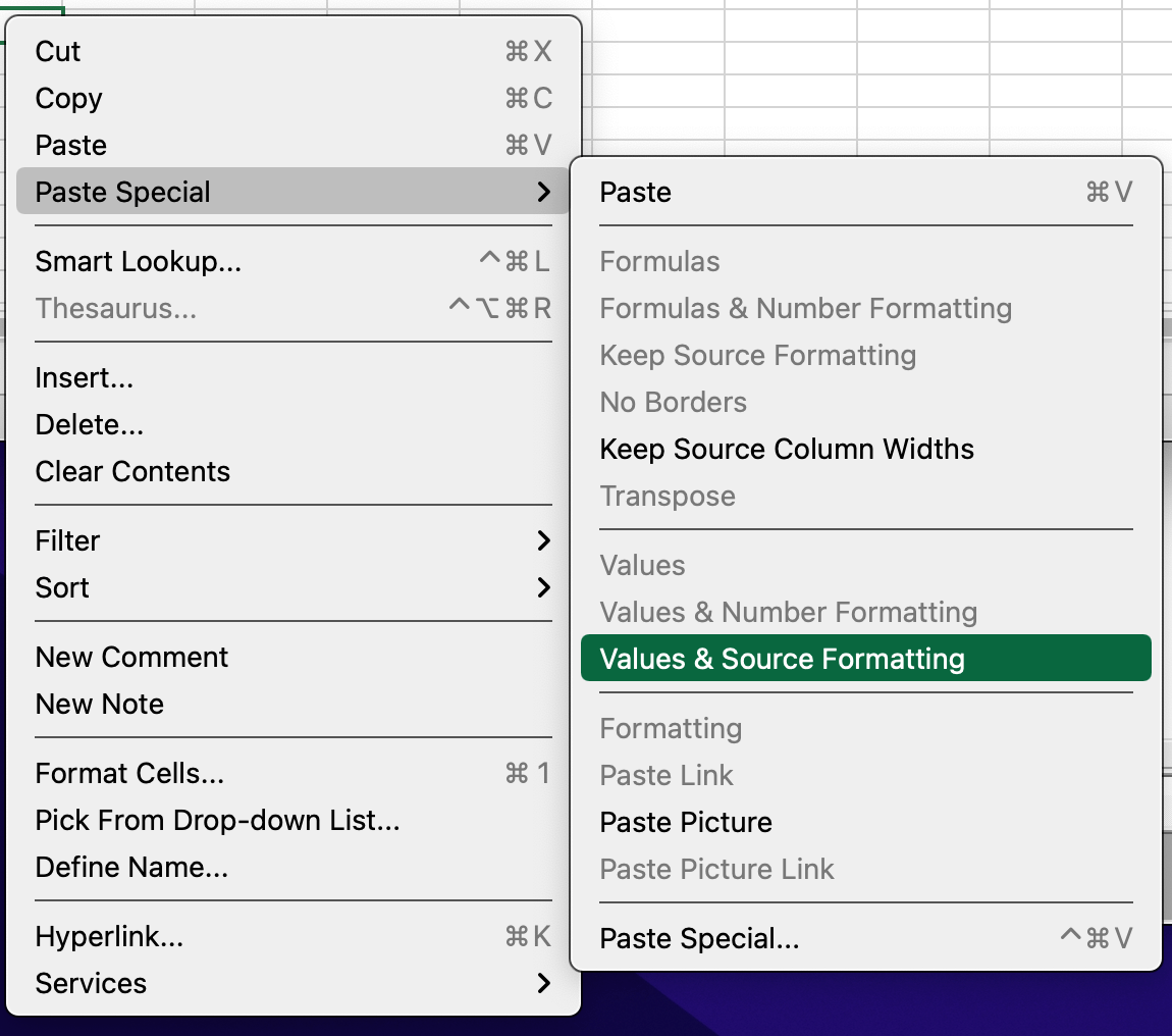

I'm using Excel for Mac 16.77.1. I'd like to create a VBA macro to do Paste Special ⇒ Values & Source Formatting (see screenshot at bottom).
Specifically, I will first manually copy the selection, and click on the starting destination cell. Then I'd like the macro to take care of the pasting. Here's what I have thus far, which I know doesn't work. What am I missing?

In searching online, I've been able to find code for copying the values from one specified range and pasting them into another. But that's too specific for my purposes. I just want a macro that executes the following generic actions, so that I can do this with a keyboard shortcut instead of mouse clicks:

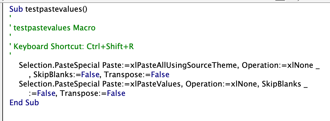

    Ah, that's a clever idea!
    Here's what it gave me when I recorded the macro:
    The problem is the Range("C8").Select statement, which causes the macro to always put the pasted values in the specific cell I chose when I recorded the macro (in this case, C8), which is not what I want (and why the macro doesn't work). The solution is simple: Remove that statement:
