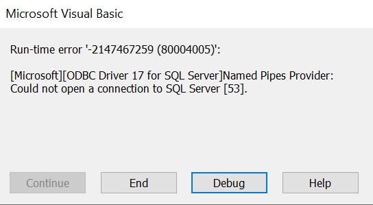

SQL Server 2019 is installed locally. I do not understand this error

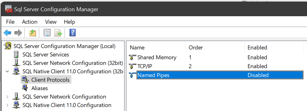

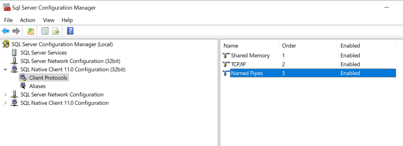

    I have enabled the ports also.

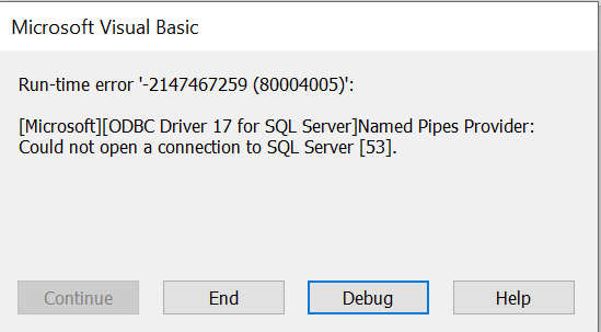

    You posted a screen shot of an error message, stating that a connection can't be opened. You follow with the statement that "This odbc connection works connecting to sql server 2019".
    I'm a bit confused now. When does it work? When does it not work? Obviously you are getting an error message.
    When and where is that error raised? And how do you know that the line of code posted actually does open an ADO connection in VBA?
    I suspect I know the problem and that it's been previously mentioned, but one step at a time.
