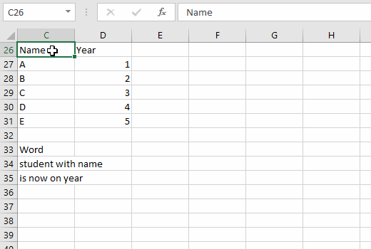

Hello I was wondering whether it is possible to achieve this result using VBA/UDF?
https://ibb.co/2yn729f
Basically what I wanted to do is to be able to concatenate various string from different cell and achieve the shown result without typing the concatenate formula over and over but only one function with VBA/UDF, so we can get different kind of result based on the chosen cells
  1. Andreas Killer 144.1K Reputation points Volunteer Moderator
    2023-11-04T10:42:54+00:00
    Sub Test()
    Dim Source As Range
    Dim i As Long
    Dim Value
    Set Source = Selection
    If Source.Areas.Count < 1 Then
    MsgBox "Select at min. 2 cells and the last cell as destination."
    Exit Sub
    End If
    For i = 1 To Source.Areas.Count - 1
    Value = Value & Source.Areas(i) & " "
    Next
    Source.Areas(Source.Areas.Count) = Left(Value, Len(Value) - 1)
    End Sub
    2023-11-03T18:02:37+00:00
    try this vba code
    select the desired cells and run the below vba macro
    result in activesheet in cell C40
    Sub Selection_Cells()
    Dim rng As Range, r As Range, tgtCell As Range
    Set rng = Selection
    Set tgtCell = Range("C40") '<< result
    Dim s As String
    If MsgBox("NOTE!!! selected area is" & vbNewLine & rng.Address & " ??", vbOKCancel) = vbCancel Then Exit Sub
    s = ""
    For Each r In rng
    If s = "" Then
    s = r.Value
    Else
    s = s & " " & r.Value
    End If
    Next
    tgtCell = s
    End Sub
    note
    add a button and assign the macro
