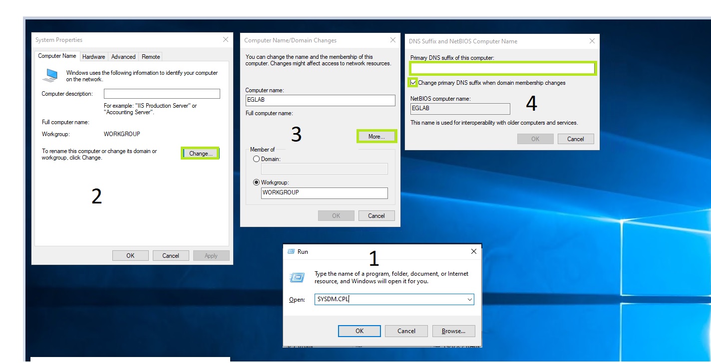

  2. Bernard 0 Reputation points
    2024-07-18T13:36:28.73+00:00
    I had this exact issue, I realized that I haven't set the correct DNS suffix in edge server which was my local domain+suffix (the one that you have on your local DC). Hope it works for you.
    To do it: Run>sysdm.cpl>change>more> there you can change it. Also make sure you check the checkbox there too. See the attached photo.Edge Issue
