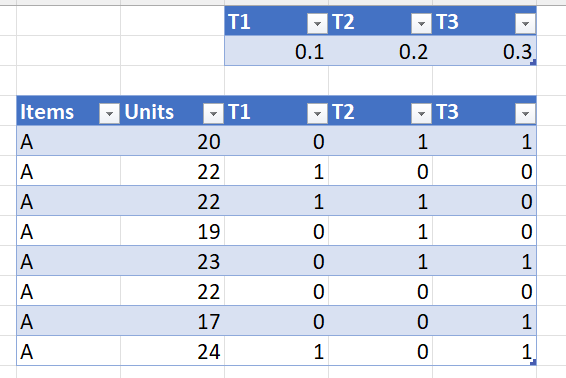

I have two tables; I've created simple example
And where I have the number 1 I want to use the value in the top table to multiply the units;
so 20 * 0.2 * 0.3, so I created this off to the side;
IF( AND( Table1[[#Headers],[T1]]=Table2[[#Headers],[T1]],Table1[@T1]=1),Table2[T1],"")
Which I then pasted in place of the 1s and 0s, and used Product ( IF( Range<>0,Range))
But is there a better more dynamic way to get the result, can I've been trying to replace the values for each column with the correct decimal, Just to add I want this in excel not power pivot,

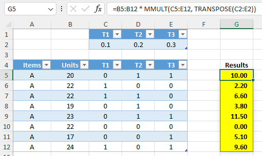

    Another approach with formula. Try this formula in cell G5:
    =B5:B12 * MMULT(C5:E12, TRANSPOSE(C2:E2))
    HTH.

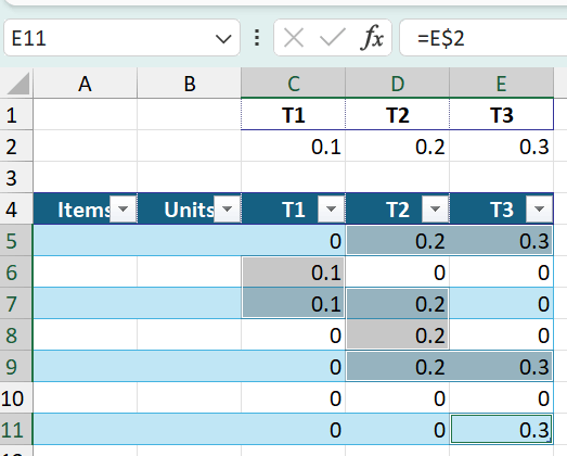

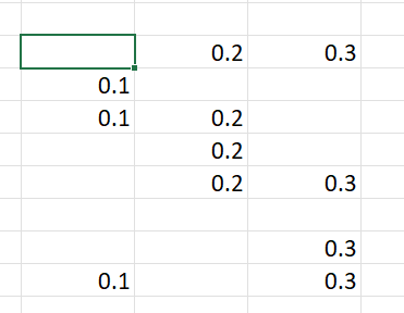

    This may be what you need. I am assuming your setup starts in A1.

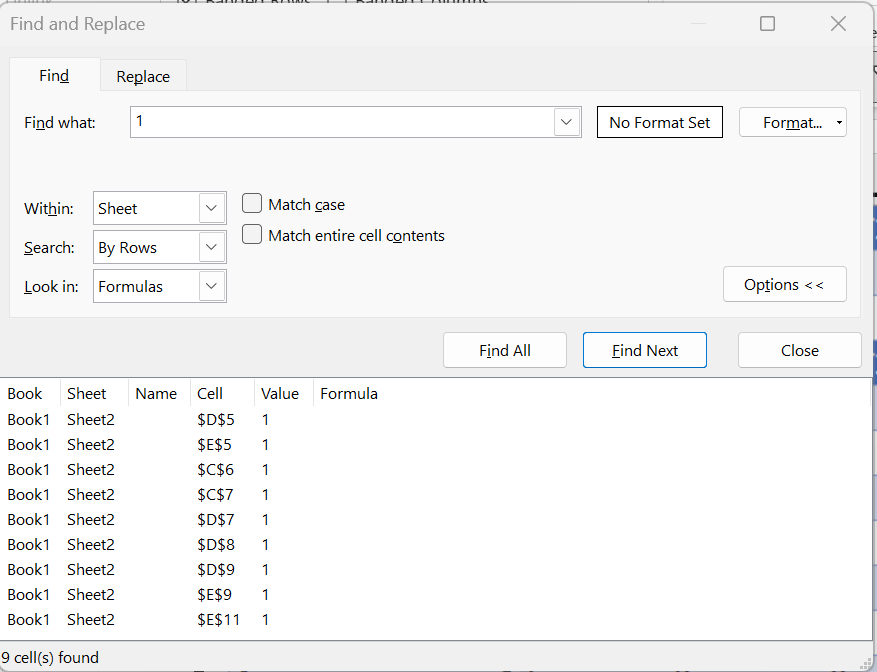

    1. Select the range C5:D11
    2. Press Ctrl+F, enter 1 in the Find what box and click Find All:
    1. In the Find and Replace dialog box the first entry will be selected, hold down the Shift key and scroll down and click the last entry (Book1 Sheet2 $E$11 1) in the above picture.
    2. Click Close. (All the cells with 1's will be selected.)
    3. Note the active cell (E11 in my case) Type =E$2
    4. Press Ctrl+Enter.

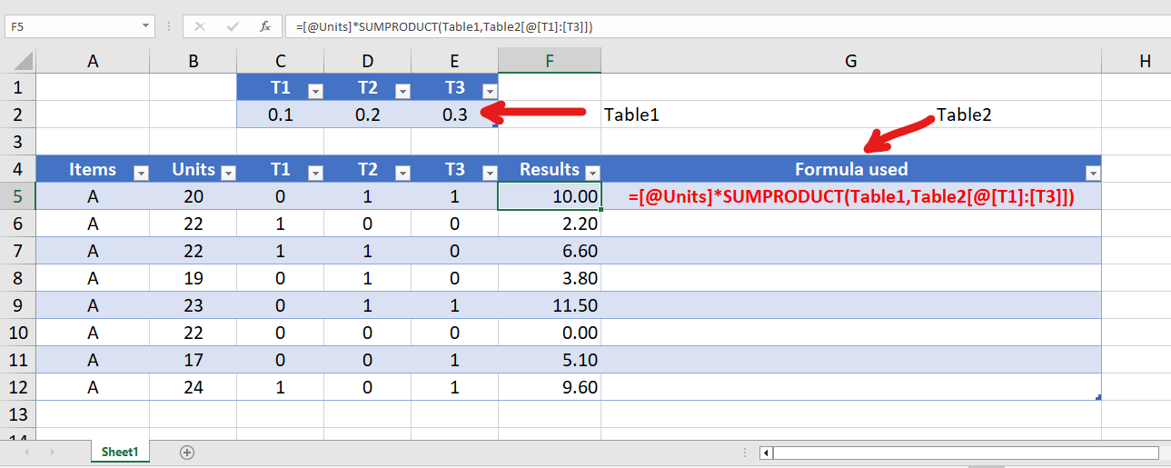

    Hi Richard
    Please,
    Try the formula =[@Units]*SUMPRODUCT(Table1,Table2[@[T1]:[T3]])
    I hope this helps you and gives a solution to your problem
    Do let me know if you need more help
