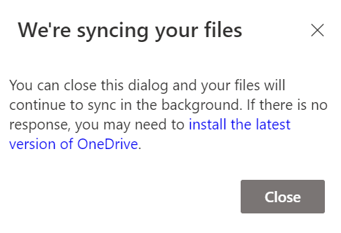

  1. Open client Sharepoint in Edge browser
  2. Click Sync button
  3. Receive confirmation that sync has begun

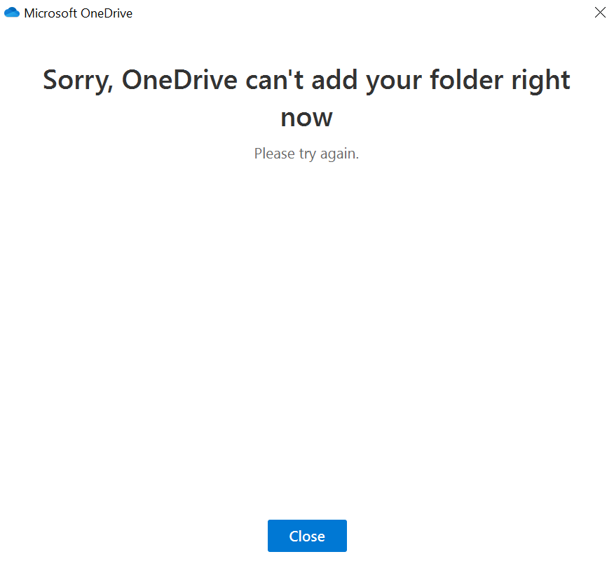

  4. Receive error message from OneDrive app

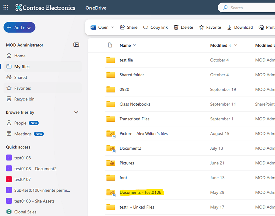

    According to your description, as far as I know, this situation may be due to the library having already been added as a shortcut to your OneDrive. Please go to OneDrive for Web (go to www.office.com, sign into your account, click the OneDrive icon in the left sidebar), click "My files" and check if you can see one folder as shown in the screenshot below.
    If the library hasn't been added as the shortcut, please try to reset OneDrive, then try to sync the library again. If the situation still happens, I wonder if it only happens to a specific library or also happens to other libraries.
    If so, it is a limitation. You should be able to see the library folder in your OneDrive local folder. Or you can remove the library shortcut from your OneDrive (in OneDrive for Web), then try to sync the library again.
    • Steve --> I confirmed with OneDrive for web that the affected client SharePoint folder does not appear

    For the shortcut in OneDrive, its folder icon has a blue arrow and its name will be "libraryname - sitename". So, according to your reply, you don't see the library folder in OneDrive.
    The limitation and the suggestion in my previous reply are based on the assumption that you have added the library as a OneDrive shortcut. For example, if you have already added a library as the shortcut to your OneDrive and set up your account in the OneDrive app, then you go to SharePoint and try to sync the library to local, the error "Sorry, OneDrive can't add your folder right now" will pop on. That's the limitation I mentioned, and why I recommend that you need to choose one of the methods (sync the library individually using the OneDrive app, Or add the library as a shortcut to your OneDrive and then sync your OneDrive files using the OneDrive app) to prevent the situation from happening.
