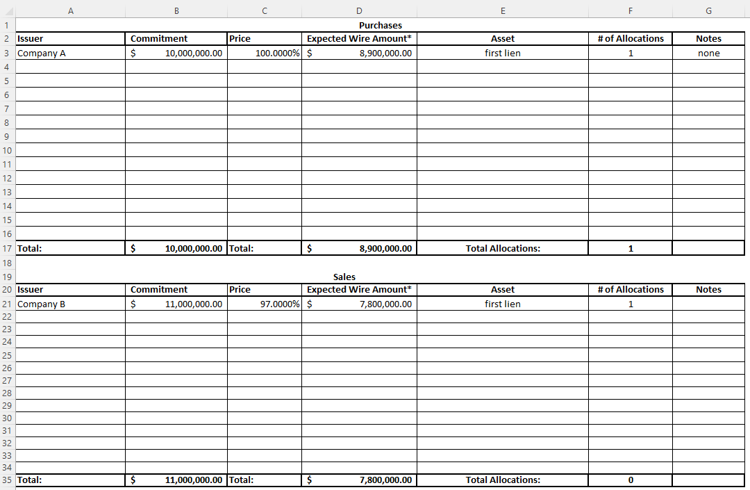

    So this is the spreadsheet with the tables the code populates into the email, and the table in the email includes all the rows that don't have data. I need a code that removes those empty rows and keeps the ones with data.
    These exact tables show up in the body of the email just like this. I need the empty rows removed.
