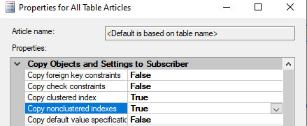

  1. Tom Phillips 17,771 Reputation points
    2021-08-24T18:51:03.877+00:00
    As a default non-clustered indexes are not transferred via replication. The subscriber can have different indexes defined to support different uses, like reporting. The reason your backup/restore worked is likely because you transferred all the indexes.
    The fact database being replicated does not have anything to do with your performance. Replication does not affect the performance of the subscriber.
