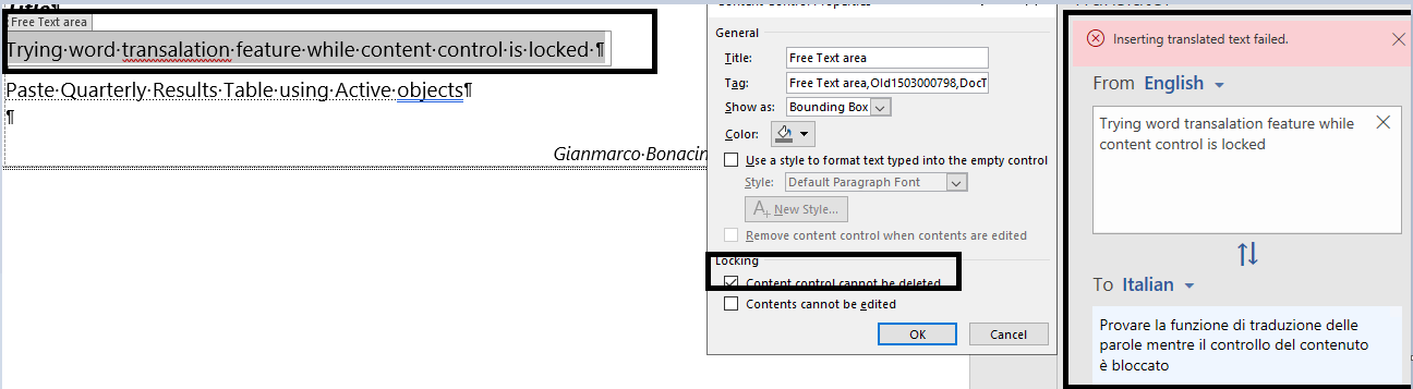

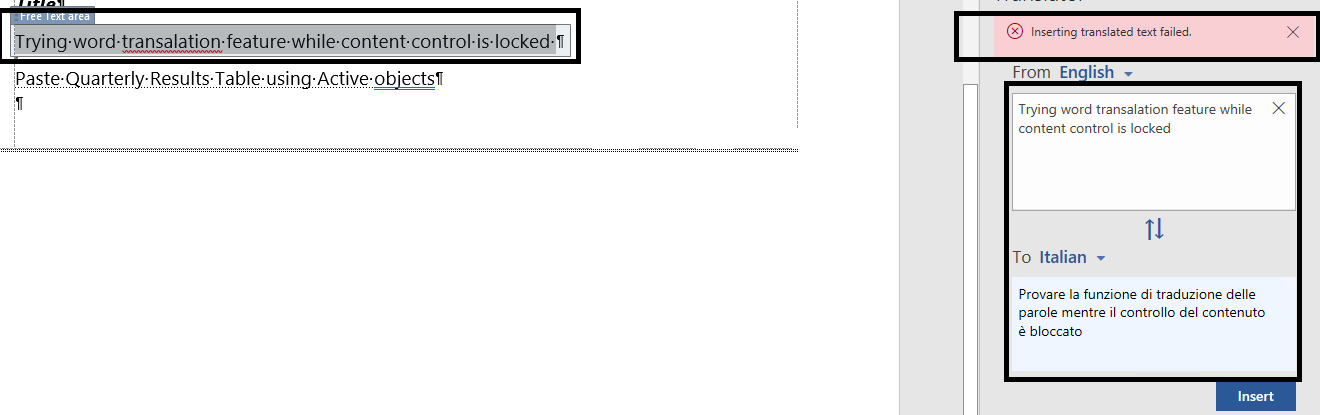

When content control is locked for deletion, word throws an error while translating the content.
Refer to the screenshot below, Content control cannot be deleted is enabled.

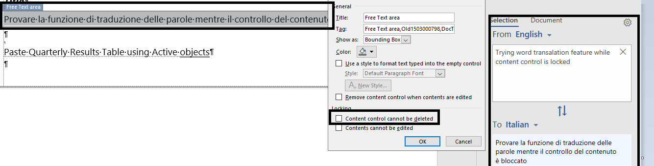

But when content control cannot be deleted is unchecked. The translation is working as expected. you can check the below screenshot.
Please help me understand if that is an expected behavior/limitation in Microsoft Word.

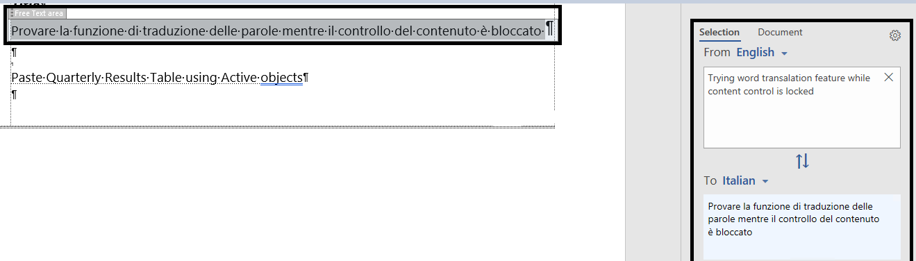

    Can you try selecting the content manually from content control along with the paragraph marker and see it you are still able to translate?
    When the content is selected manually, within the Content Control, the translation and insertion happen without problem.

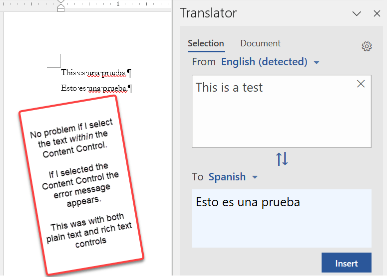

    Are you selecting the content within the Content Control and using Translate? If I did, I had no trouble.
    However, if I selected the Content Control, I got your error message.
    Image.

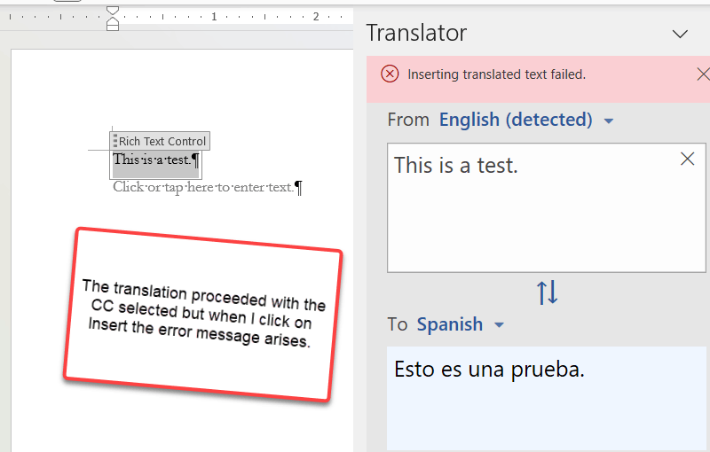

  3. Charles Kenyon 167.8K Reputation points Volunteer Moderator
    2023-10-17T18:39:14+00:00
    Apparently, you are selecting the Content Control and Word is trying to replace it with the translation.
    The obvious workaround, as you have discovered, is to uncheck the option to keep from deleting the content control.
