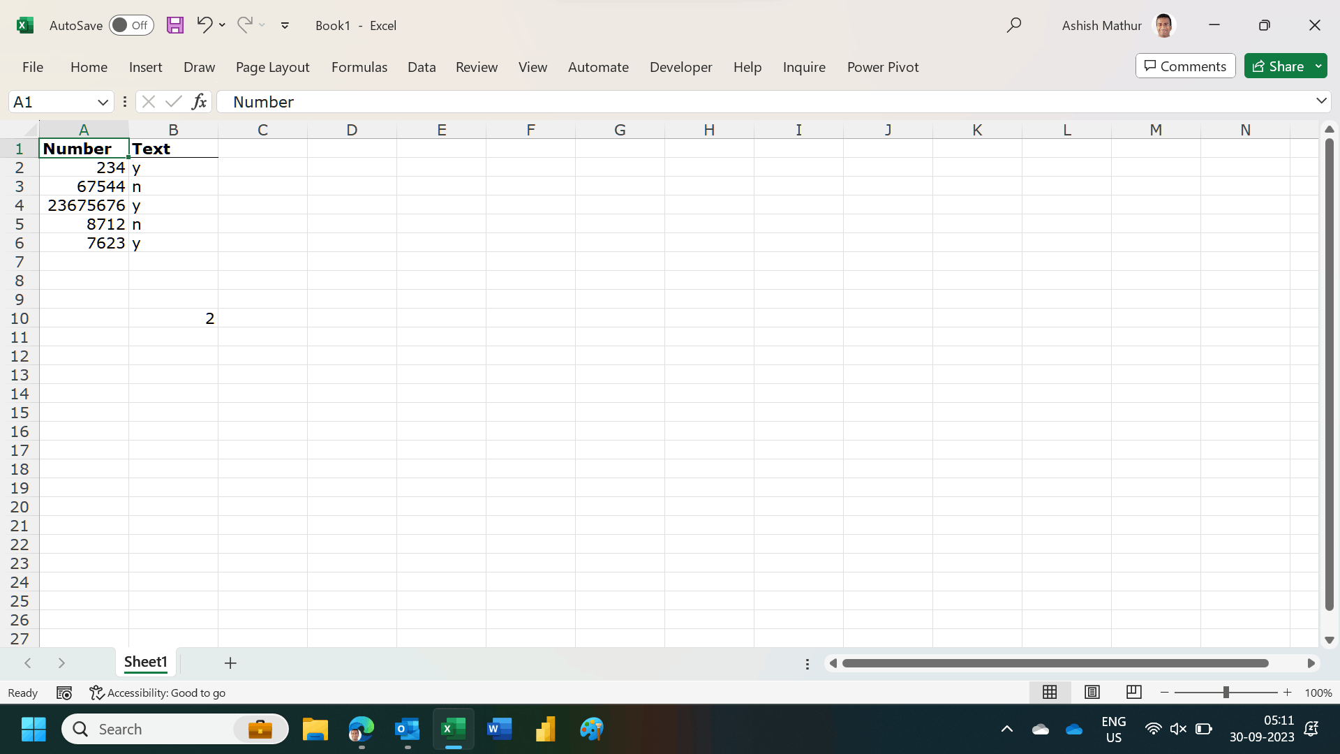

  4. Ashish Mathur 102K Reputation points Volunteer Moderator
    2023-09-29T23:42:14+00:00
    This works
    =SUMPRODUCT((LEFT(A2:A6,2)=23&"")*(B2:B6="y"))
    Hope this helps.
