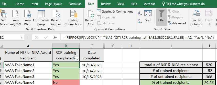

=IFERROR(IF(VLOOKUP("*"&A2, 'CITI RCR training list'!$A$2:$B$5029,1,FALSE) = A2, "Yes"), "No")

Here is an example of the final product so far for reference:
