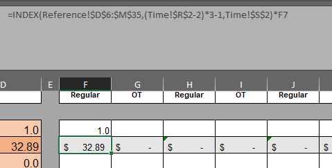

    Try this one.
    =INDEX(Reference!$D$6:$M$35,(Time!$R$2-2)*3-1,Time!$S$2)*F7

    2024-03-04T14:00:53+00:00
    That worked the way I wanted it too. Thank you!
