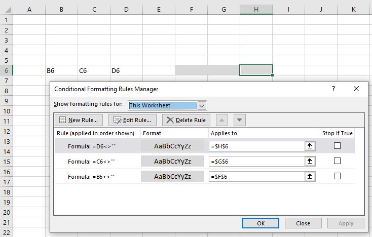

    Firstly, sorry about my misleading. There are no operator % in my system that just a typo mistake $ to %.
    Here is my demo file for implement.
    Demo file

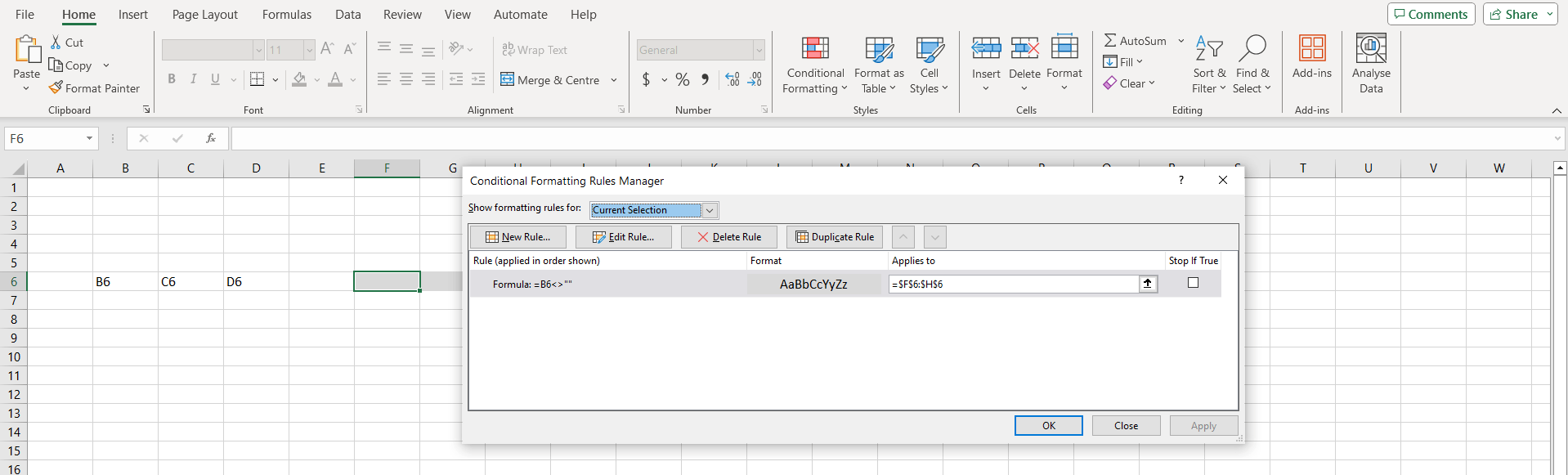

    I apply the rule for cell F6=B6<>"" (mean if B6 change the value F6 will be automatic fill color). The problem is at first I apply the rule Applies to only equals to $F$6 after I save and close it. I open again the range is change to =$F$6:$H$6.
    Please help me for this issue
    Thanks

    2024-01-05T09:45:18+00:00
    Hi Andreas,
    That's correct Applies to when you only apply F6,
    I mean to reproduce this issue, you need to applies these cell
    F6:
    Formular=B6<>""
    Applies to=$F$6
    G6:
    Formular=C6<>""
    Applies to=$G$6
    H6:
    Formular=D6<>""
    Applies to=$H$6
    After you apply these rule above, please save and open again. You will see the rule of 3 cells will be change
    Thanks
    Tai.

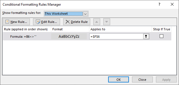

  4. Andreas Killer 144K Reputation points Volunteer Moderator
    2024-01-05T09:37:02+00:00
    Hi Tai,
    that sounds strange. Please download this file:
    https://www.dropbox.com/scl/fi/z65oq5bg6cje12dt9cq5w/f67b367e-5401-4d4e-a2e8-ad87a45a8e19.xlsx?rlkey=y4ayt0b0dc5xplyw9hhmqwwfe&dl=1
    It's your file, just the CF applied to F6 only. If I open the file I see this:
    The rule is applied to F6 only, not issue.
    What do you see on your system when you open the file?
    Andreas.

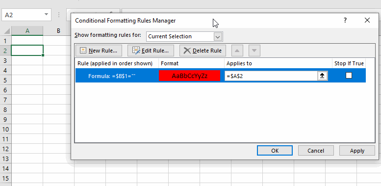

  5. Andreas Killer 144K Reputation points Volunteer Moderator
    2024-01-05T09:54:05+00:00
    Hi Tai,
    I can also not reproduce that behavior. Please download my sample file again, I've added 2 CF.
    If I open the file I can see this:
    No issue on my side. What do you see on your system?
    Andreas.
